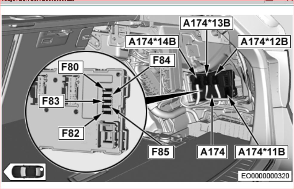

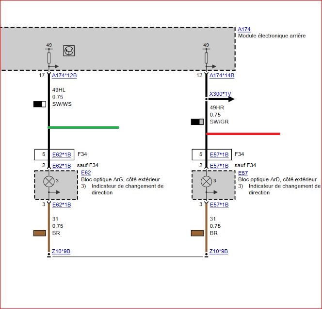

they are the interior parts has changed?
To connect:
son green plugs into slot A174 * 12 location 14B
son red plugs into slot A174 * 17 location 12B
Do you have references please contactors

Hi David, I don't have reference contractors. The harness is plug & play with the green wire feeding to REM - LEFT (Pin 20) & red wire feeding to REM - RIGHT (Pin 22). Then coding to open ports for power.
If you order the harness, Alex provides an authenticated link to his video instructions.
