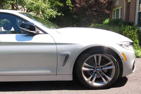

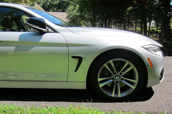

I used a cheap set of trim pullers from Harbor Freight:
http://www.harborfreight.com/5-piece...set-67021.html
to do this.
I removed mine to vinyl wrap them to a color that better suited my car's color than the default black color:
Before (black) & After (anthracite):

Looks much better.... you just pulled them out? I want to change mines for a carbon fiber set.

Yes, they just pull off, but you need to be careful as they are fragile. A plastic puller is usefull here. These are available on ebay and amazon.
