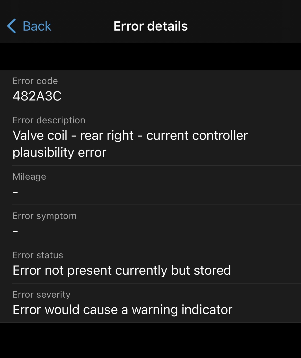

UPDATE: I scanned the car and this is the error I keep getting even after replacing the EDC with a brand new one from KW.
Any help on what could be causing this would be greatly appreciated!
