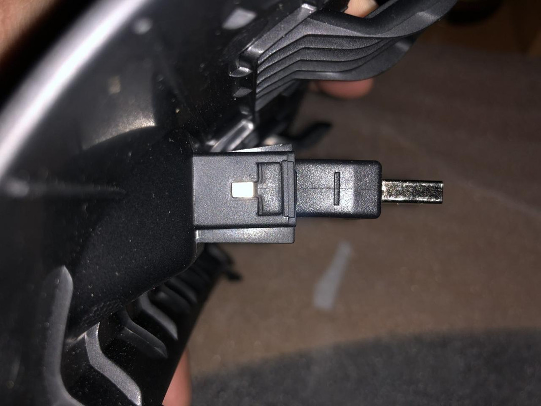

RHD cars have the USB connector on the left of the trim panel, and LHD cars have it on the right for some reason.
I also ordered both the adaptors that I linked to in a previous post:
https://www.ebay.co.uk/itm/USB-2-0-A...53.m2749.l2649
https://www.ebay.co.uk/itm/12cm-Shor...53.m2749.l2649
The double ended adaptor arrived first, so I test fitted it.
I trimmed a little of the rubber with a blade, so that it would sit in far enough.
It pushes up tight, to where I have trimmed too, which should keep it in place just as it is, but I might add a dab of glue before I fit it to the car (I will be testing the other adaptor cable first, when it arrives).
