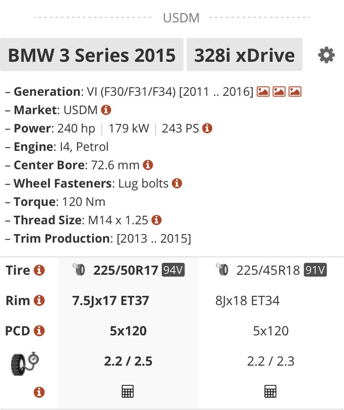

Originally Posted by chowser51 View Post
Buy the spacers. You can try to mount a wheel but you’ll quickly find it won’t work. The et54 offset will not work without spacers. Our offset is 30 something.
I just checked the offset myself which i should have just done in the first place! They are 32 not 54!
