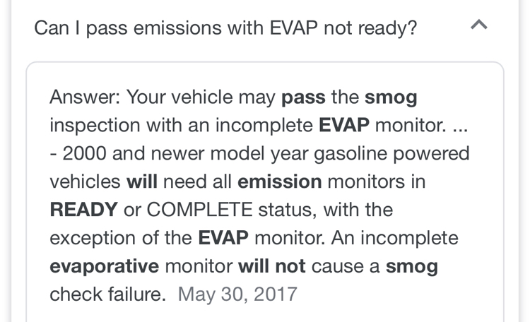

Anyone know if the EVAP monitors requires to do the complete drive cycle?
All my other monitors are good besides EVAP.
