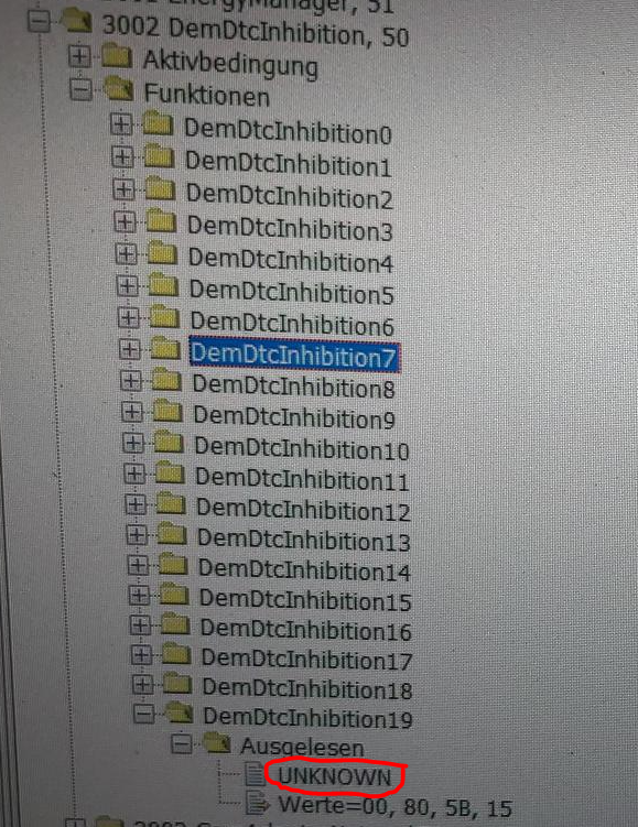

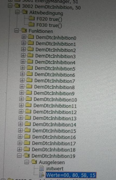

So I have found in FEM CAFD, a parameter called DemDtcInhibition
I found a line that has Werte=00, 00, 00, 00
Replaced it with the relevant error code (805B15) as Werte=00, 80, 5B, 15
I changed the "off" to "initwert"
Please see the first picture attached.
However, when I rechecked to see if the coding was successful, I got what you see in the second picture: the "initwert" got changed to "UNKNOWN". If I changed the "UNKNOWN" back to "initwert", then the Werte value went back to 00,00,00,00
Have I done something wrong?

Leave it like that, it wont affect anything

try change the location.
If you put custom data in esys it will show as UNKNOWN
