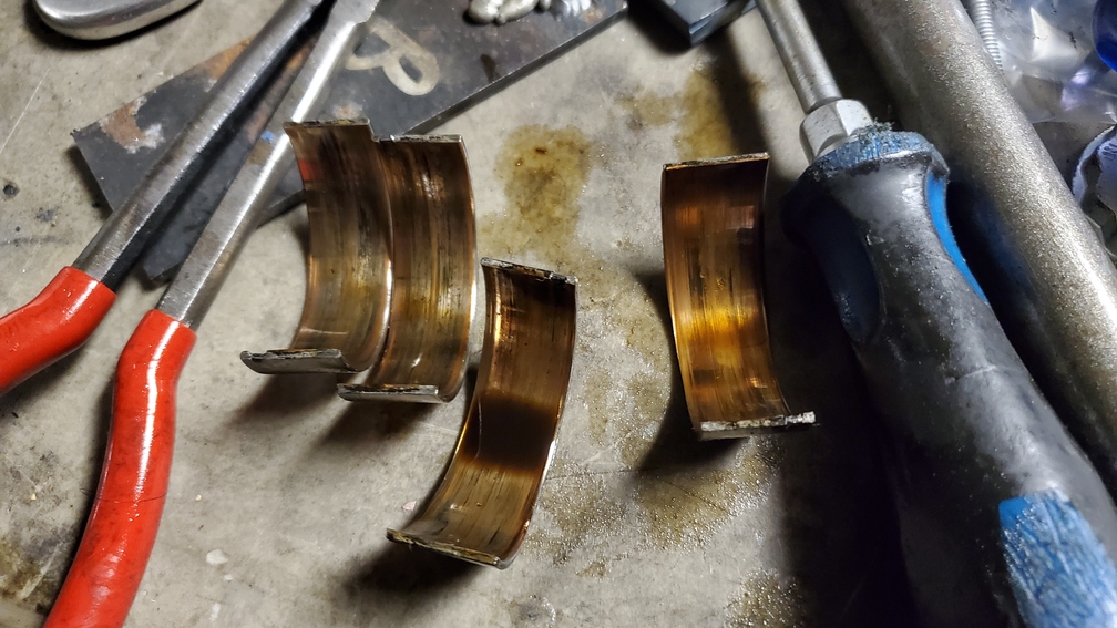

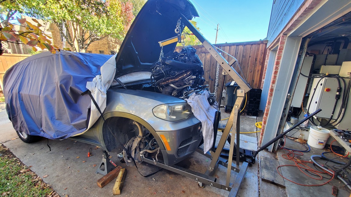

So on November 2, my engine locked up on the highway.
The starter could turn over maybe 1 turn. But it was otherwise seized.
3 rod bearings had spun. There were no engine codes.

AbbeyRoad, can you please share the condition of your main bearings, oil starvation or OSI related problem will show some signs of wear throughout all of the crank bearings.
About half the bearings had heavy scoring, both rods and mains. Yikes, it's was BAD in there! And most likely this started long before I got the vehicle because there was a bunch of metal in the filter when I got the car. I was running 15W50 to compensate for bearing wear.
It is entirely possible that the last hard pull I did sucked some air into the oil pickup. The oil was low-ish. I guess we will never know. I would like to think it is impossible to suck air into the pickup on ANY car unless the oil level is below the MIN mark. But maybe BMW messed up.
