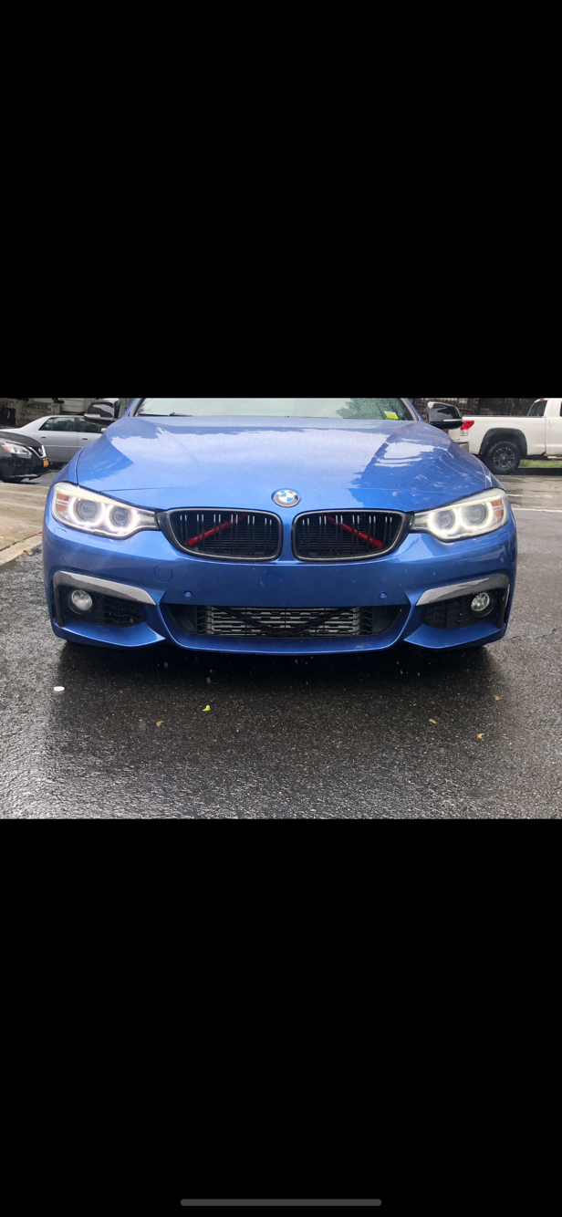

Originally Posted by E90 LCI View Post
My friend who installed my intercooler did it through the bottom of the bumper. He didnt remove anything
Check your front bumper. You probably don’t have the bar in front of the intercooler like I do.

Originally Posted by Tymula_81 View Post
Mine fit with the bars there
What version intercooler are you using? My VRSF 6" Race has no chance of fitting with the OEM V brace. See pics below

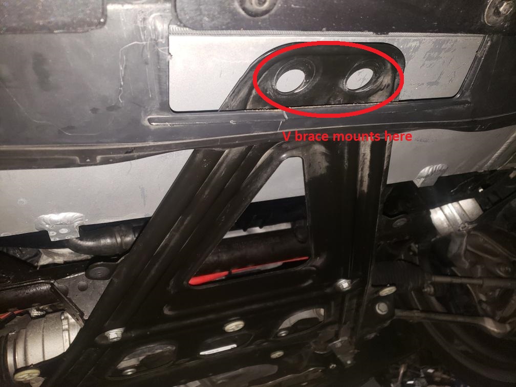

To clarify the bottom of the V brace mounts here:
What I did was unbolt the brace that goes back to the doors. I got a mallet and hit the vbrace where the intercooler goes a few times and kept test fitting it till it fit proper. Only other option is something custom or remove the brace which is probably not safe being that it's there for a reason.
Tymula, I just don't see how I'll be able to use a mallet to gain the 2" i need to mount this brace. Did you look at the pics I posted?
I will say that I have noticed some slight reduction in body stiffness. Mostly when on very uneven/grooved payment, especially when braking hard.

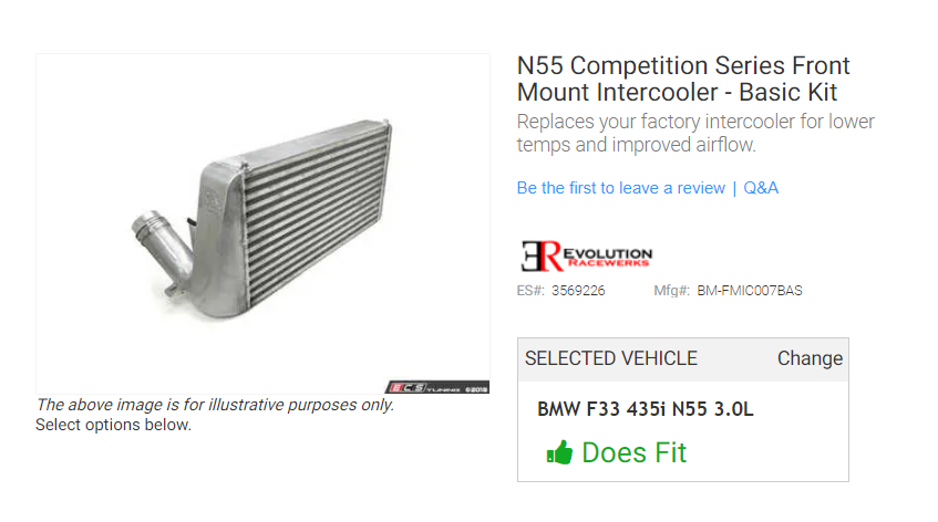

Right now I feel like I have the following options:
1) Replace the VRSF 6" race intercooler with a unit guaranteed to fit. Thus far searches on ECS tuning are comingback with few options. Wagner 2 Evo, Turner, AC, and most notably the Evolution Raceworks competition.
See attached photo. Link:
https://www.ecstuning.com/b-evolutio...fmic007bas~dk/
2) Custom fabricate the brace to work with the VRSF 6" race intercooler.

If our intercooler didn't fit, the Evolution Raceworks won't fit either since they occupy the same space. If you're unwilling to use spacers or modify the brace you're going to have to downgrade to a smaller intercooler.

Originally Posted by Tiago@VRSF View Post
I've had the chance to ride in a F33 with the brace removed and wasn't personally able to feel a difference in rigidity but I'll see what we can do about getting an upgrade made
Lol just take my money now!
For real though my installer and I agree something could be fabricated relatively easily to fit. As far as the F33 goes, I think it could use as much rigidity as it could possibly get. Just gotta find me a local fab shop that won’t charge up the wazoo to get this done.
In the end my goal is to add non hinged upper & lower strut braces, solid sub frame bushings, new sway bars and an LSD. Then I’ll go Billstein B14 to finish it off. Hoping this will help the car feel more grounded. Just wish there was a better way to address the poor handling and feel on these F30’s (coming from a E93 M3 I can really notice the difference).
2014 Cabrio M-Sport 435i, MHD Stage 2+, Wagner HFC Downpipe, VRSF Race FMIC, CP & TIC, GFB DV+, EOS PI, AIC2-V, Fuel-IT Stage 3 525.
Any news on finding a solution with the OEM V brace or on a custom fabrication?
