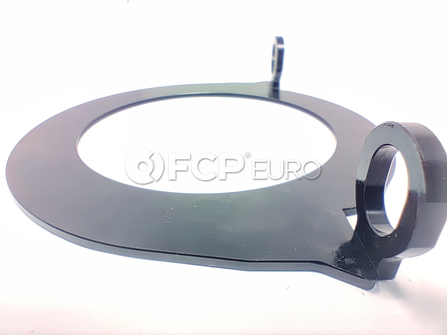

The next big thing was the drive belt. I removed the cooling fan for a little extra clearance. Again, this isn't required, but I'd rather spend 15 min up front removing something than to spend 30 min fighting and then ultimately remove the thing anyway.
So as many know, with proper maintenance, the n55 drive belt isn't really a problem. However, the time, oil, and/or coolant will allow the belt to stretch. The design of the harmonic balancer won't allow the belt to fall off the front. So if the belt jumps off the pulley, it can get forced through the front main seal and ruin the engine.
For peace of mind and longevity of this car, I decided to get a crank seal guard. There are 2 main options out there: Something like the Vargas Turbo Tech that is billet, but flat on the back, and something like the Kies Motorsports that is billet with a centering ring on the back. Refer to this thread for more info, but the summary is that the Kies design fits a little tighter, is a little more sturdy, and provides a little more protection. I chose to spend twice the money for the peace of mind.
So I marked the harmonic balancer so it would go on in the same orientation, removed the bolts, and then removed the balancer. All the old and new parts neatly laid out. The Kies bolts are longer to accommodate the guard.
*Note the Bentley manual for instructions and specs. If you don't have one, go get one. It's nice to have all the CORRECT instructions in one place.*
And installed. It's hidden behind the harmonic balancer, so no one will ever see it.
