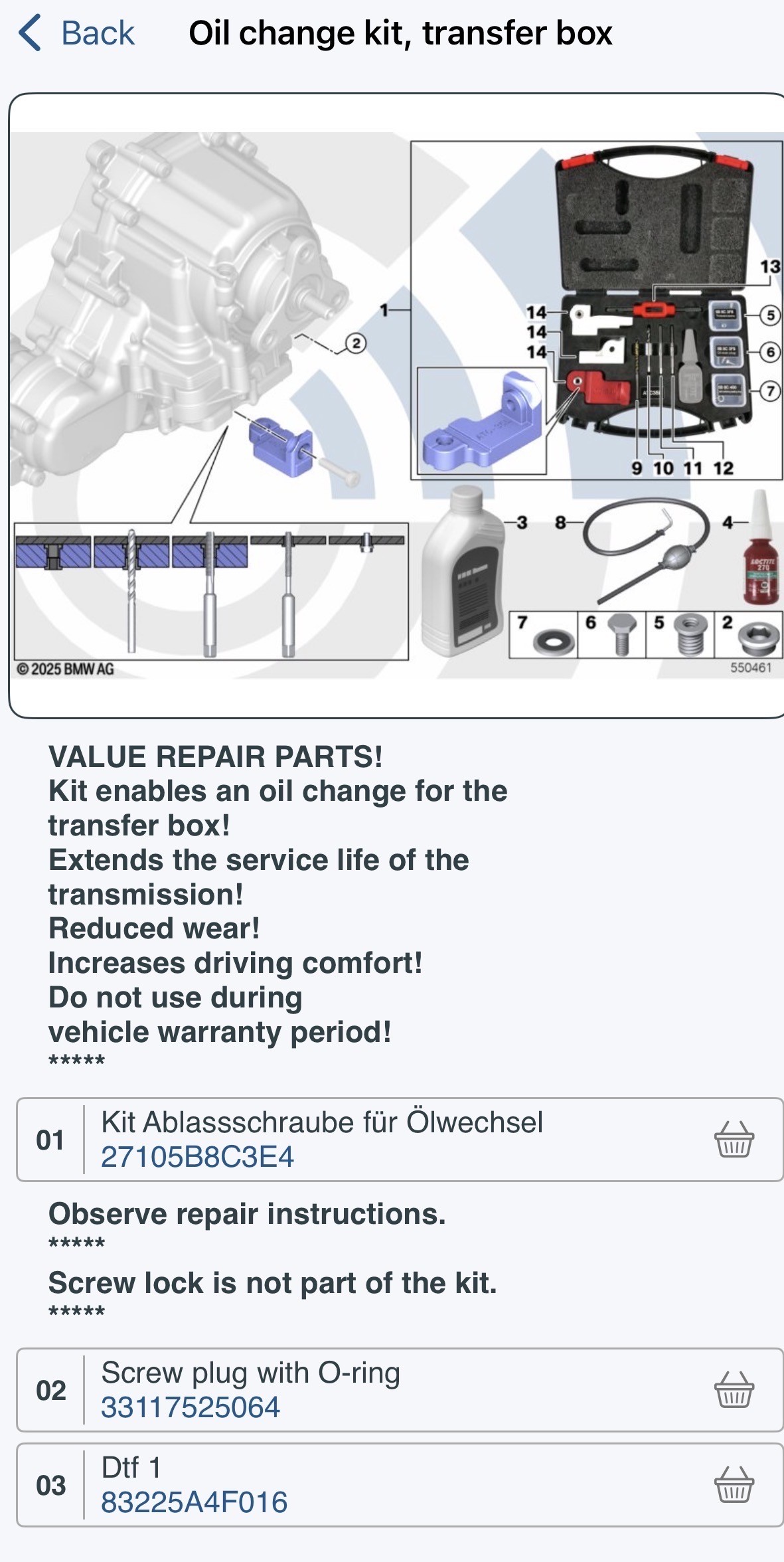

Hopefully this might help someone. I was browsing the parts catalog (as you do) and since 10/25 it looks like BMW have now released a tool to introduce a drain plug into the ATC35L. To allow for complete oil changes. Now, it’s very new so isn’t listed on many sites but it looks like it’s very expensive. Part number for kit is 27105B8C3E4. You won’t find on RealOEM by the way as their catalog is only 03/2025, but see attached image for reference.
A bit more searching then brought me to a German automotive tool company that have developed a very similar product:
XXL-Automotive
So I decided to order it (back order, not in stock currently). It’ll be nice to be able to drain the transfer case easily. Worth the extra expense vs trying to extract via fill hole.
Wires2435.50
Vortex817.00

What is stupid annoying is our Audi SQ5 has the same transfer case, but it had the drain plugs. Thanks BMW for saving a couple pennies here... And considering eventually all BMW's start leaking from every seal area, I'd risk one more potential leak point with that bung!
But having #8 in that parts kit would be stellar for the drain.
Just wondering if you go this yet, and how it was to do if you did.
