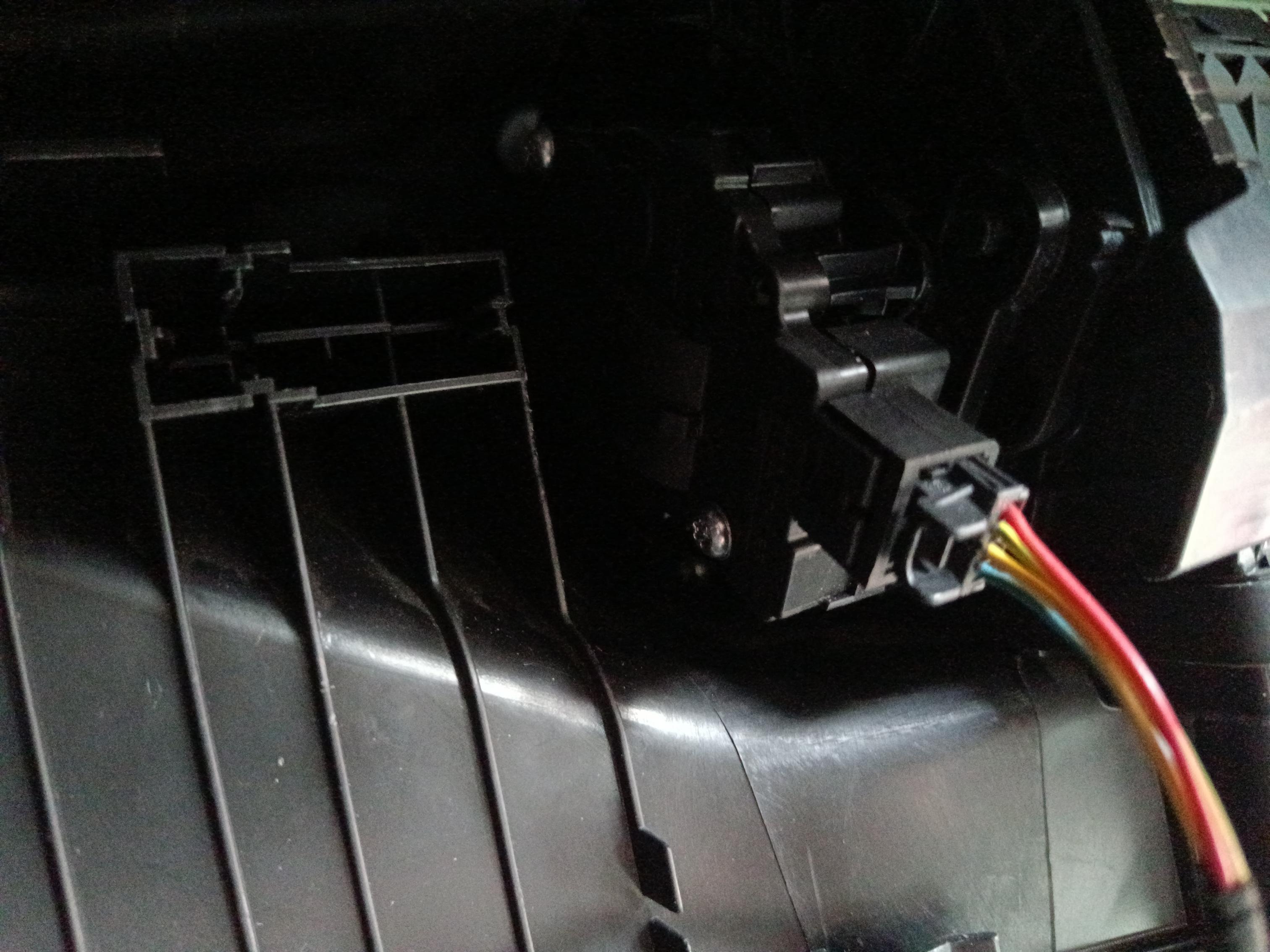

Hi, I'm having trouble setting the temperature to 28°C on both sides. Only the driver's side blows warm air; the passenger side barely blows any. If I set the air conditioning to 16°C, both sides blow cold air normally. I replaced the mixing flap actuator on the heater core, to the right of the module, but that didn't solve the problem. I then checked the flap actuator on the right side of the center console, but it's working fine. I then checked the actuator next to the module again, and I could move it freely by hand, even though it's screwed in. Is it possible that the plastic part where I mounted the actuator is damaged and needs to be replaced?

This is the actuator that i changed, and i can move it with my hand
