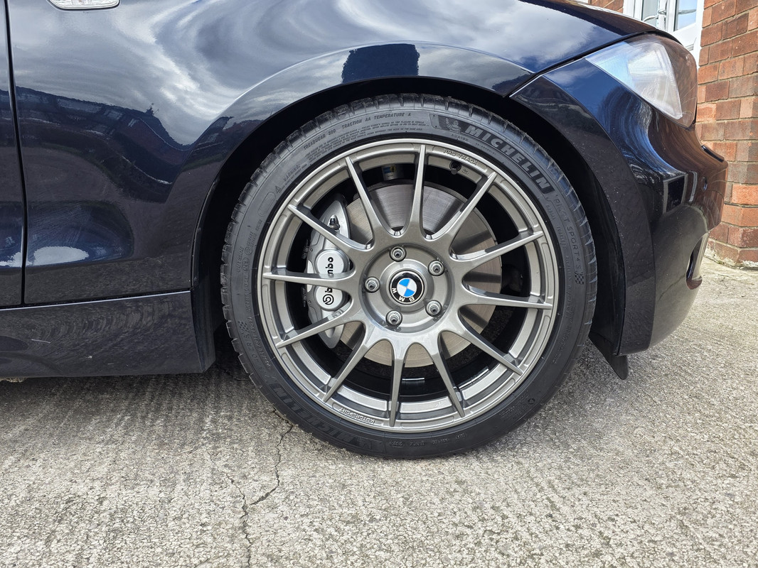

Personally I'd go with a straight set of 18x9 all round and run 245/40 tyres - will look much better and will be better handling / better turn in feel
Anthracite is a lovely colour in the flesh; exactly the same wheels I had on my E81 130i LE - this is when I fitted them:
https://www.pistonheads.com/gassing/...=2093671&i=460
Superb wheels; superb light and very well made
Re fitting; just get new bolts all round, or a stud conversion kit etc

Silver would look superb; but when I enquired about them, I was told it was a 5 month back log; so worth asking now
However you could always get them refurbished
They take OEM nuts fine; no need for any aftermarket ones; unless you buy new ones so they don't look scabby etc
And 18x9 ET30 should be perfect, no need for spacers etc
