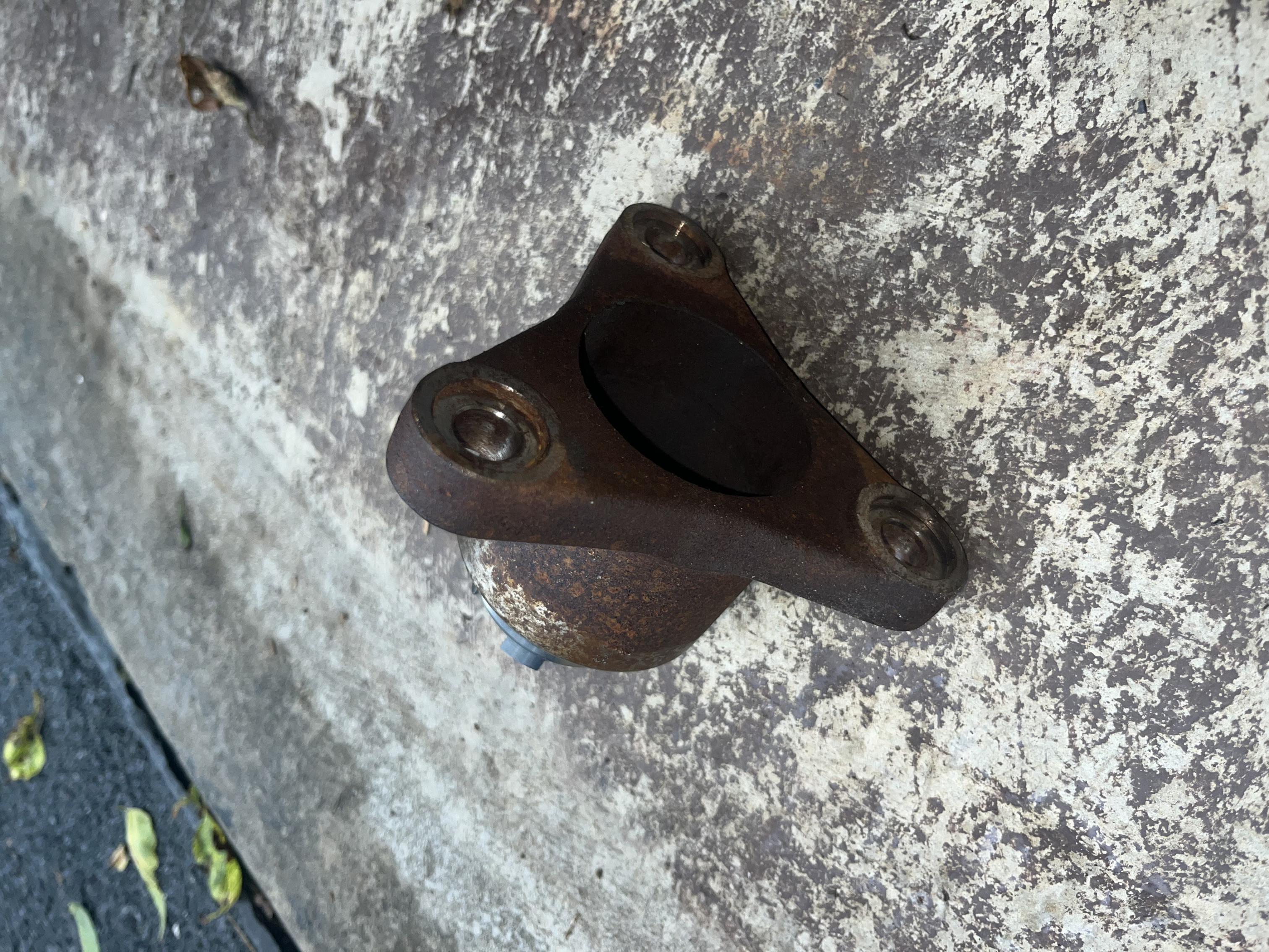

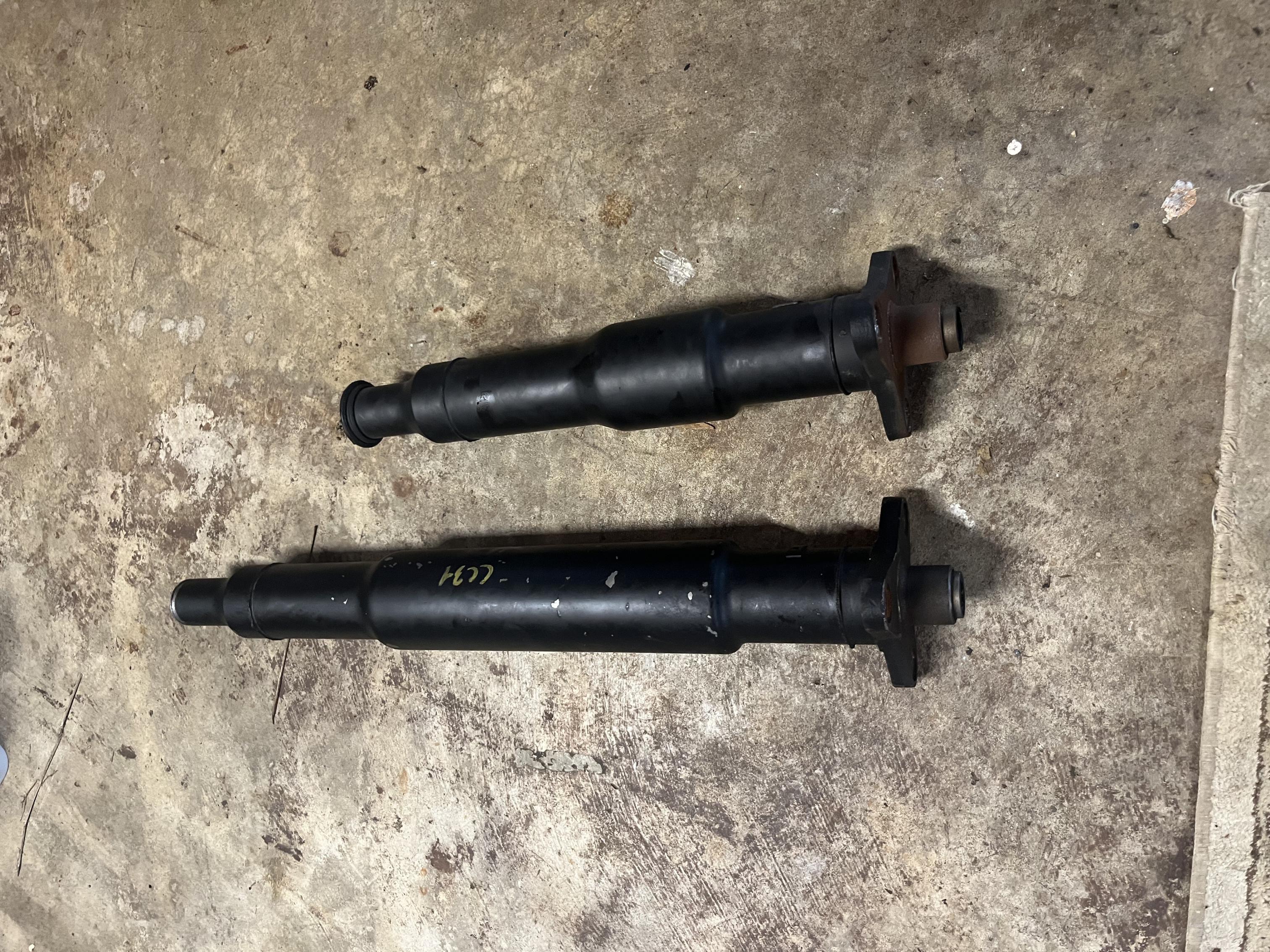

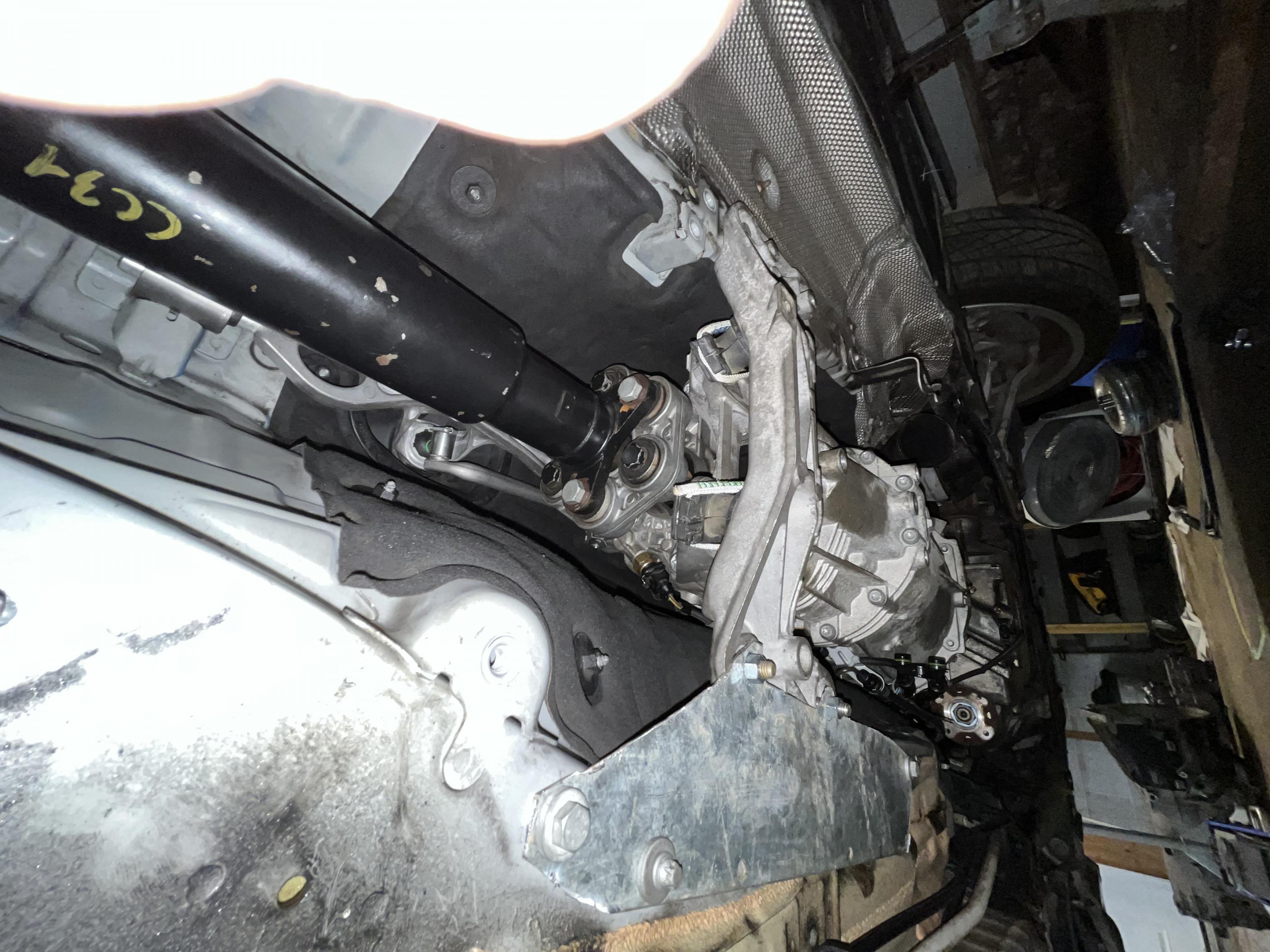

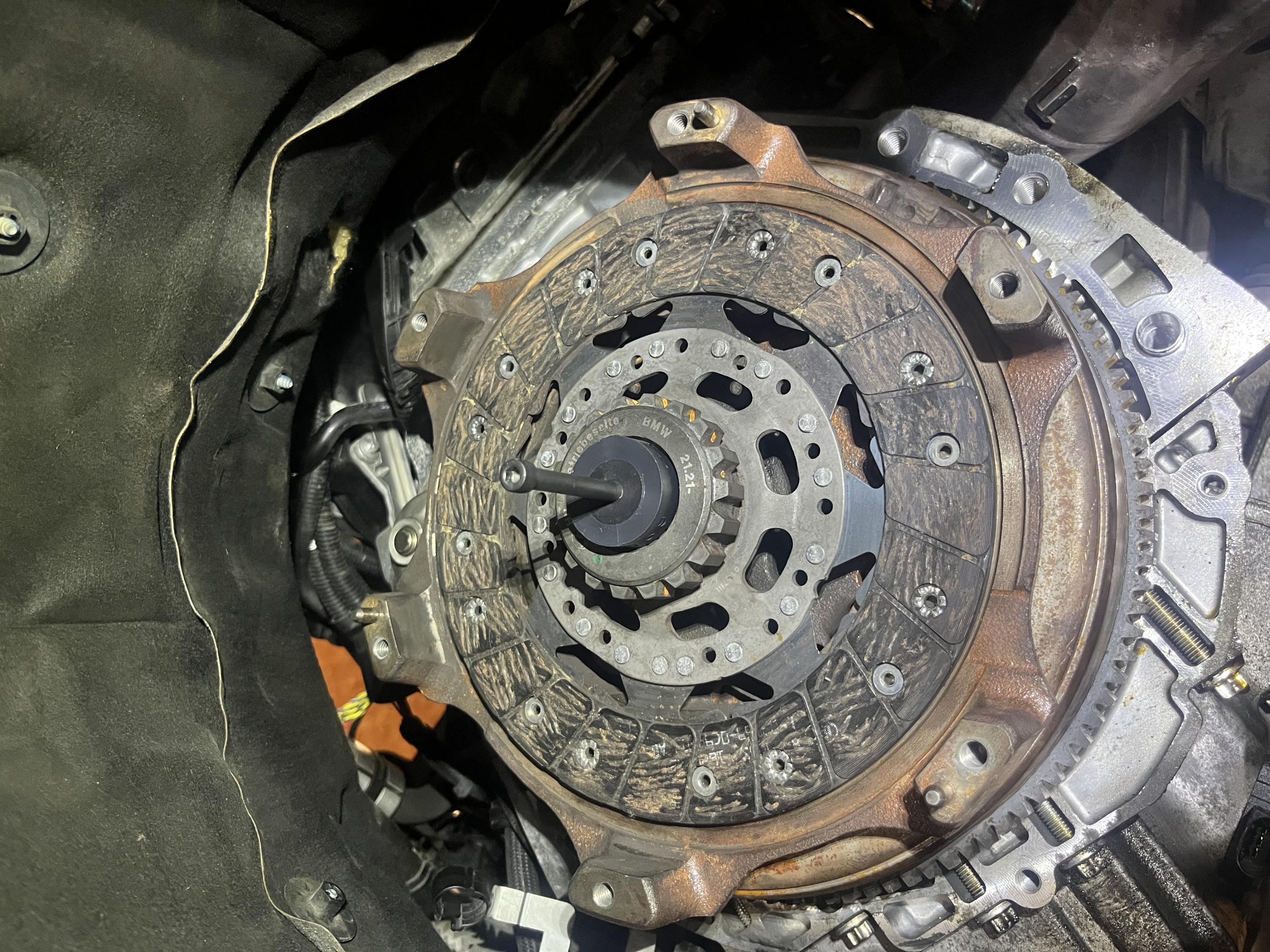

Hello fellow enthusiest. I took on a challenging project and have succesfully converted my daily driver 2014 335xi Auto into a manual RWD car. The car drives amazing and flawless and I am very glad I did this. I am running a 58k mile M4 manual transmission (ZF-GS6-45bz) (SHBS) with its factory flywheel, twin disc clutch, and pressure plate. Aswell as the f80 trans mount and shifter mechanism. For the drive shaft I used one from an f30 335i RWD AUTO. There is about an inch of spline showing but I think it will be fine. Due to this car being an Xdrive car, half the RWD trans mount bolted to the car, and the other half had nothing to mount to. I used a grinder to make my own custom trans mount bracket out of sheet metal. Its ugly but functionality wise is perfect. I had to run wires from the clutch module to the DME and FEM, and ran wires for the reverse switch to the FEM. In order for the m4 tranny to work, I had to drill and tap a hole in the transmisison for the reverse switch. I also had to take off the f80 output flange and replace it with one from an f30 335i gs6-45bz transmission. I did not wire in the zero-gear sensor as it does not affect the cars driving nor gives me any lights on the dash. Getting into the DME connectors to add pins is very trickey, so I did not bother. Aswell as the f30 neutral sensor will not work with the f80 transmission. If someone knows a way to get the f80 gear sensor to work on an f30 that would be great. All of the coding was done using ESYS. I FA coded all of the modules to type key 3A93(RWD) and deleted the $205 from the list of options. The only module I had to revert back to factory coding was the EPS module. I have zero lights on the dash, but get a code on my reader that relates to the DME not seeing the VTG(transfer case). This does not affect the car at all. If anyone is genuinly curious to try to do this themselves I can add another post that goes into greater detail. All in all I loved banging through gears in the Xdrive auto setup, but just missed having the third pedal. Prolly the best mod I have ever done. Thanks.
