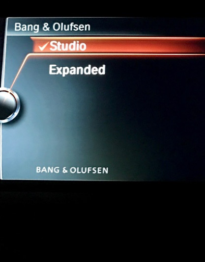

      05-26-2024, 03:13 PM   #48
NealfromNZ
NealfromNZ's Avatar
New Zealand
1400
1,226
Drives: 2016 F80 M3
Join Date: Aug 2022
Location: New Zealand
blau3er
Would you mind a question with the B&O system. Does it have two or three sound profiles ?
Eg
Profile 1 normal ( Nothing ticked )
profile 2 Studio ( ticked )
Profile 3 Expanded ( ticked )
Or is it just the two with Studio and Expanded ?
Just working on something at the moment with Idrive
      05-26-2024, 03:21 PM   #49
blau3er
1619
928
Drives: Fire Orange M340i Touring
Join Date: Mar 2020
It only has two options.
After living with it for some time now, I use Studio for a better listening experience!

      05-27-2024, 07:22 AM   #51
blau3er
1619
928
Join Date: Mar 2020
Originally Posted by NealfromNZ View Post
Perfect , thanks for replying. Context for the question is putting a feature request into a dsp / amp company to allow more that 2 maps to be used ( they have 4 slots ).
Was checking B&O mapping capability. Couldn’t tell if it was 2 or 3.
I’m guessing studio has less sound field processing so probably more hifi like .
Studio mode, according to B&O, "produces a vivid sound stage similar to a recording studio".
Obviously that is Marketing BS - however the studio mode is so much clearer and defined across the whole range, and importantly for me, the bass is much tighter and less boomy.
For those who want "more" bass, expanded mode probably sounds like it has more bass, but it does not have the clarity of studio.
