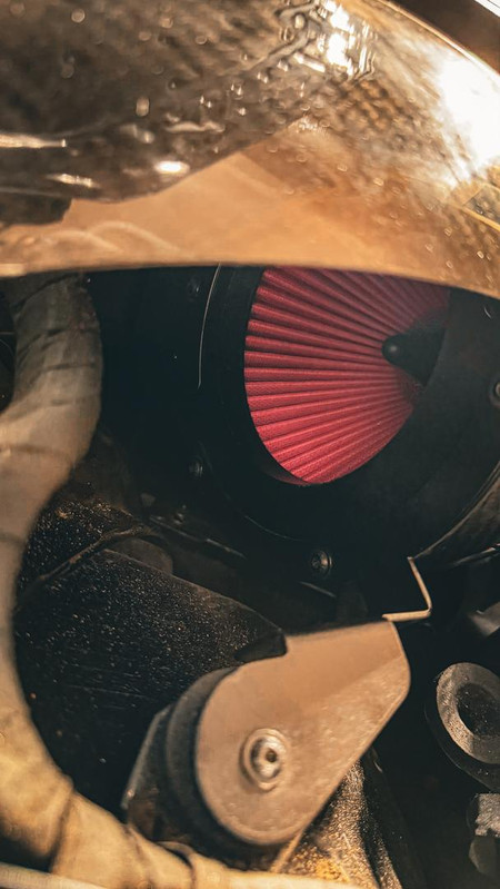

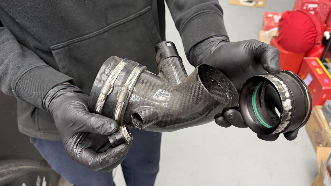

While doing the intake we noticed the Dinan Turbo Inlet in CF that I have installed had a loose air hose, upon closer inspection and removal of it, the plastic fittings completely came out of the CF. My assumption is the epoxy/glue that they used has failed under heat. Means I had a small air leak this whole time without knowing it. Really dissapointed in Dinan quality honestly. We were able to re-epoxy the fittings and hopefully theyll last now:

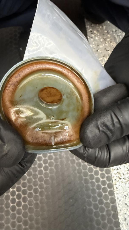

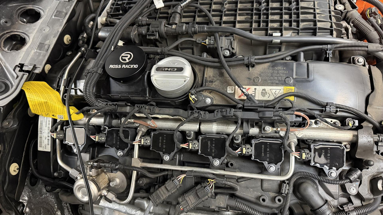

Had the Ross Racing PCV billet cap kit in my trunk for a couple of years and at 62k miles I decided to just install it as a preventative maintains item. When we removed my factory diaphragm we did confirm it had a ton of tears and rips, so was close to giving way if I did not do this:
New Diaphragm and Cap installed:

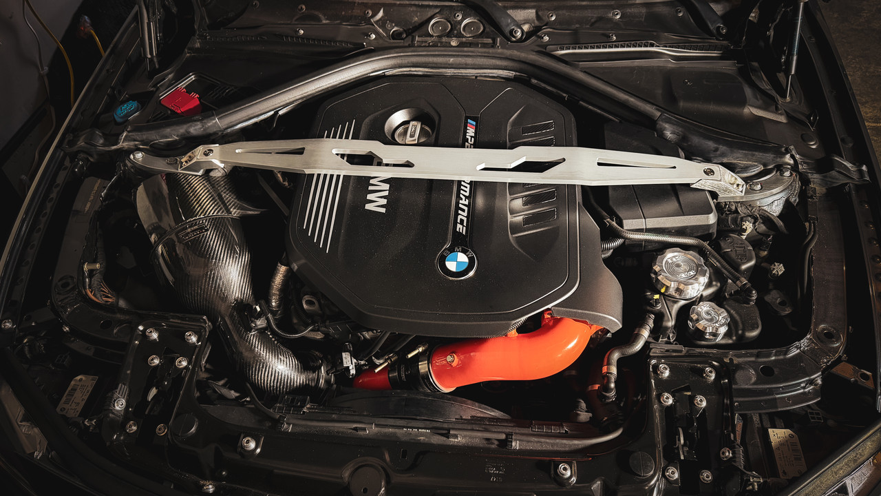

To clean up my engine bay a bit, I decided to continue to remove some of the orange bits. I was watching some Bimmer Invasion videos and I gotta say everyone seems to run the accent-color-color-matched Gearwrench caps with a matching turbo or charge pipe, with matching downstar hardware. Felt like I was part of that same cookie-cutter mod trend. Decided to change it up a bit out of boredom and just the want to not have a cliche BMW engine bay.

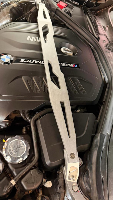

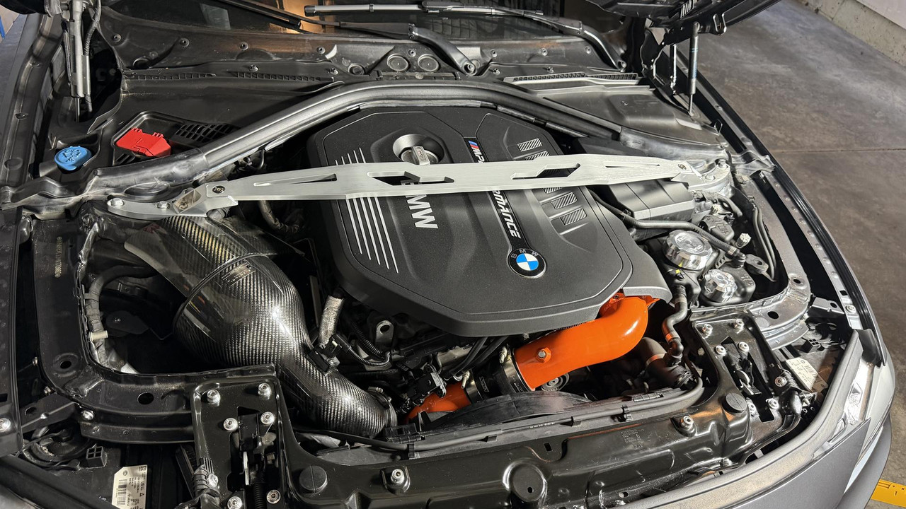

I changed my Downstar washers from Orange to Raw Aluminum. Changed my CF Strut Brace to a Bilet Brushed Aluminum bar, very happy with how it looks, it's a lot sturdier and it's a lot easier to remove if I need to work on the engine... night and day difference really.
Some pics of the new engine bay and the new strut brace:

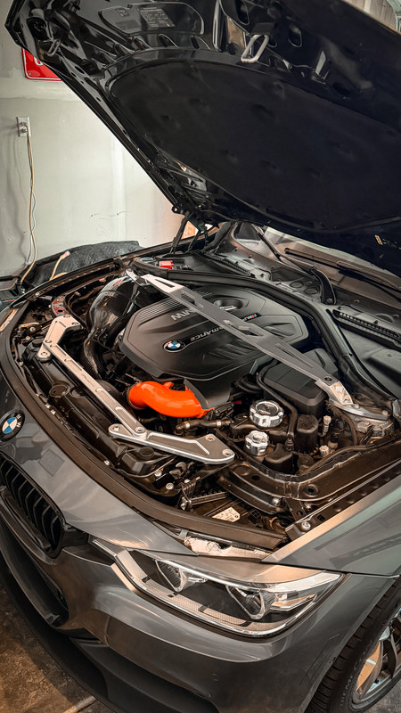

Engine bay:

Engine bay looks great! Even though I’m a slut for CF that new bar is pretty damn cool too.
Any interest on adding M bits? I’ve always thought the swap for the M3 CF engine brace was the ultimate option

I have a U Brace coming in aluminum as well that’ll serve same purpose as the f80 one, never really thought the f80 brace was a good option since it’s so restricting to get to stuff in engine bay. Even this new strut brace won me over due to how much easier it is to remove compared to my ECS carbon one which was an extremely tight fit.

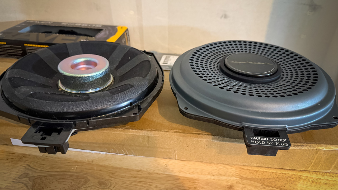

Bavsound Ghost v3 subwoofers

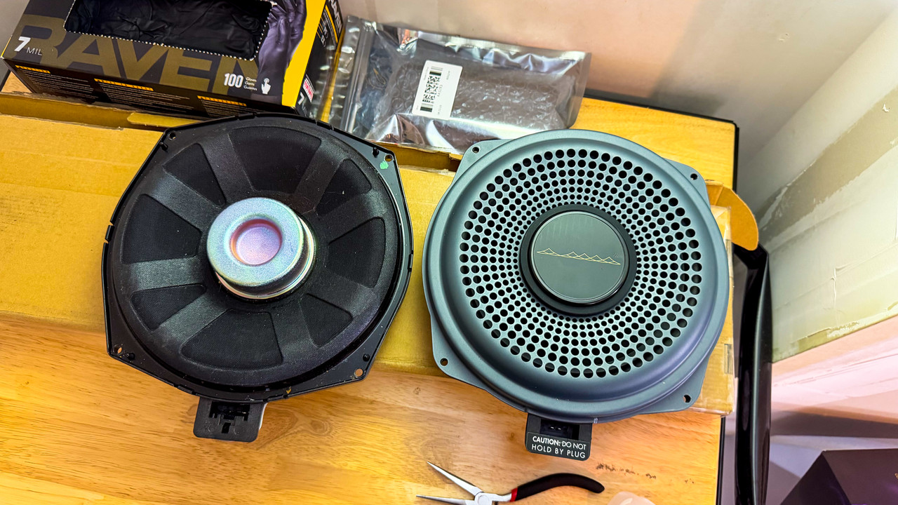

Bavsound recently held a clearance sale for some B-Stock items they had, I've been eyeing their subwoofer upgrade in the past few months and saw that it was one of the offered items at a decent discount. Decided to take the opportunity and purchase them. The subs came in pretty good shape, can't tell if they were used or not, or simply had scratches from factory that Bavsound didn't want to sell as A-Stock. Either way, they live under a seat with a cover over them, no one will ever see them. Luckily, they still offer a 4-year limited warranty, so my main concern was them being operational not pretty.

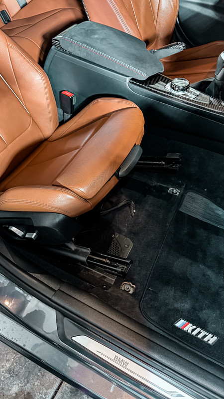

I used the "lean-back method" to get under the seat, tilting them back after removing the seat rail bolts and having them sell fall back to the back giving me room to remove the stock HK subs. The job was easy but a lot more annoying that I thought, should've maybe removed the whole sub box to give myself more access. But got it done.
Overall, I'm happy with the results, with windows closed you can really tell the added clarity and power of these new subs. HK bass always sounded muddy to me, so this was a nice upgrade to clean up the sound profile imo. Would I love to upgrade the amp and speakers? I'd love to, but for HK the amp is $2,000 alone which to me isn't worth it. For now, this will be my sole audio upgrade.
Accessing the subwoofers:
HK vs Bavsound Ghost v3 comparison:

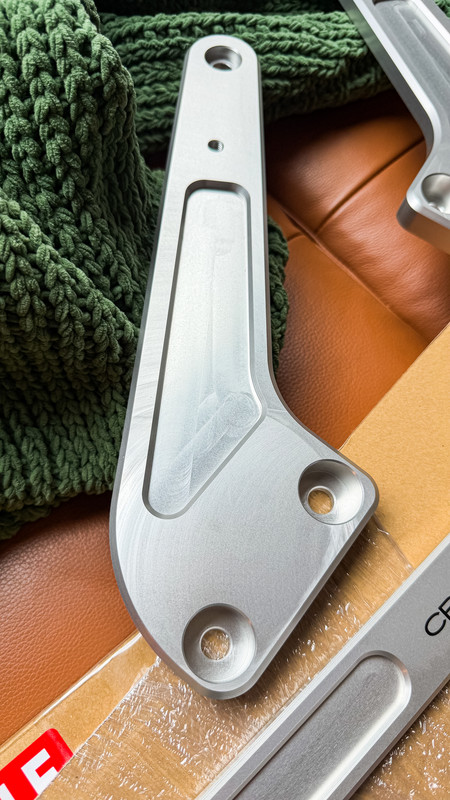

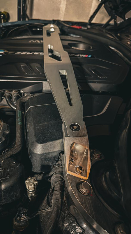

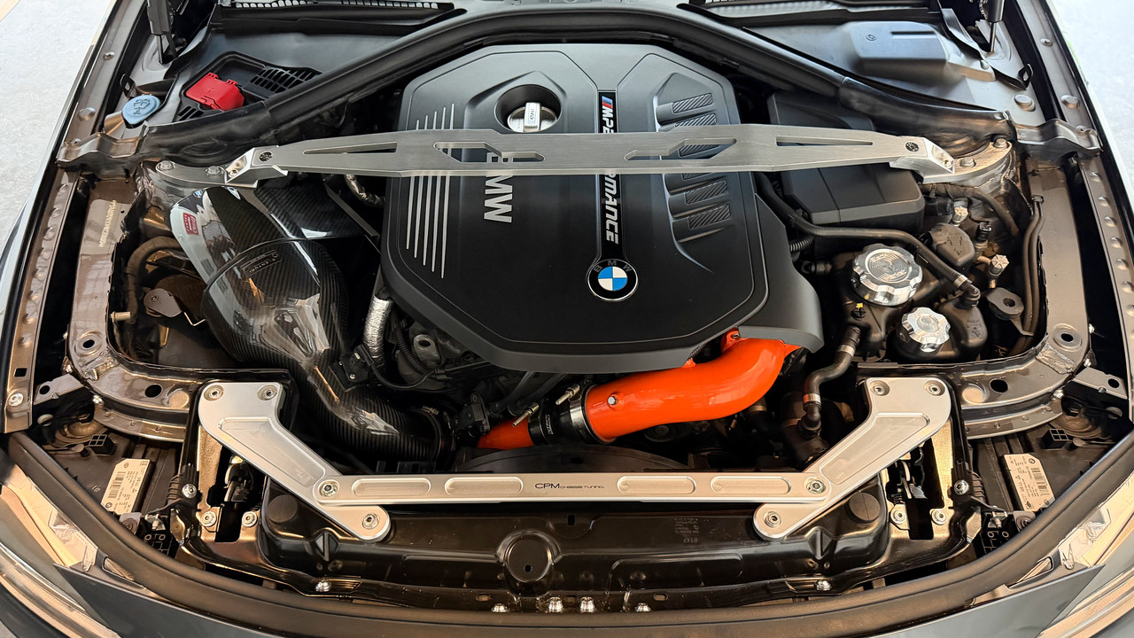

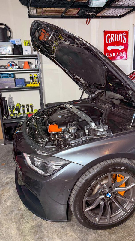

CPM Front Brace

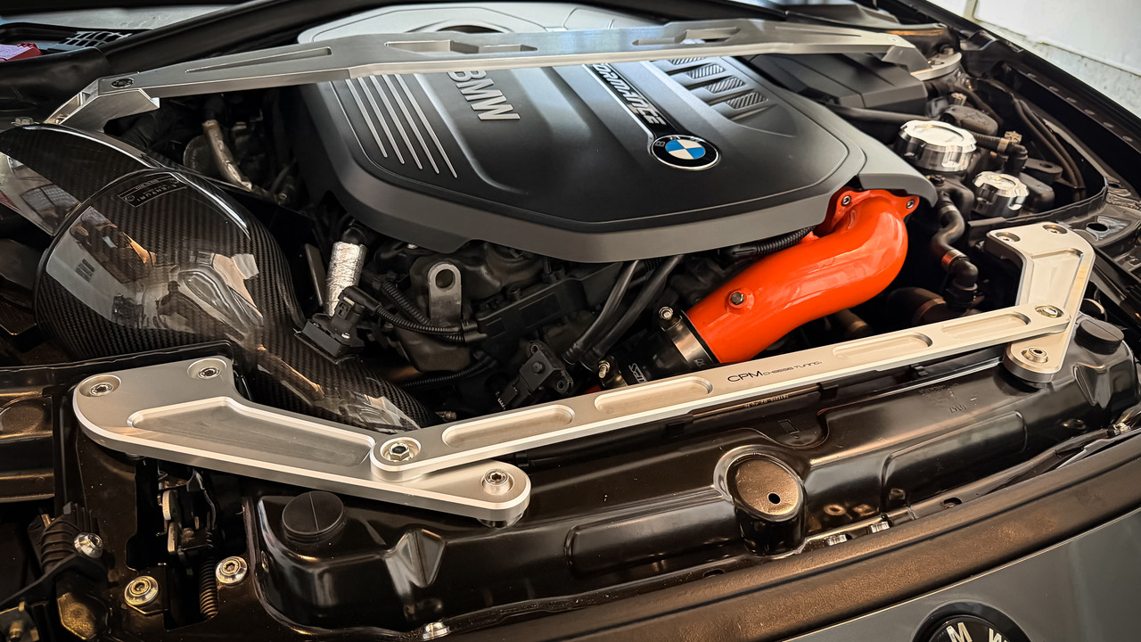

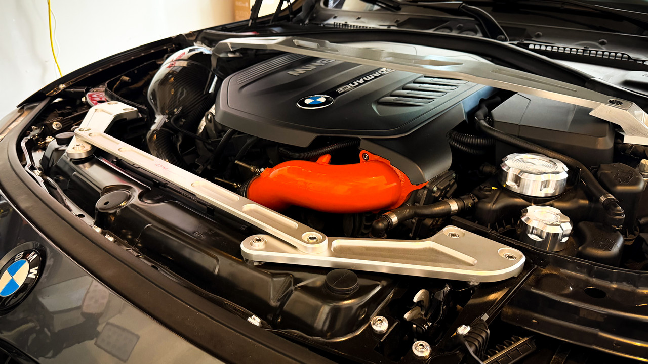

This upgrade was inspired by disintegrator66 after I saw this installed on his car. I thought it complimented my new strut brace well, so I decided to order one. I feel with this brace all the benefits of the OEM F80 carbon strut brace are achieved, the struts and the front end of the car are now connected. Very impressed with Japanese quality, the milling is amazing and it feels like a high-end product. A breath of fresh air after a few misses from Ali/Chineseum products I've had to deal with lately.
Installed:
Still trying to figure out if I want to keep the Orange charge pipe or go with something raw/industrial, options are limited for that. For now, I think it looks impressive even as is:
