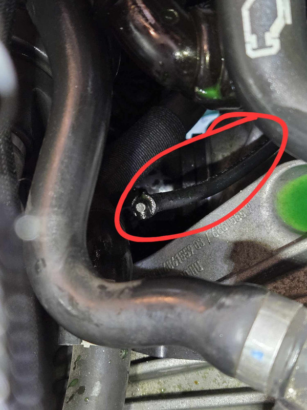

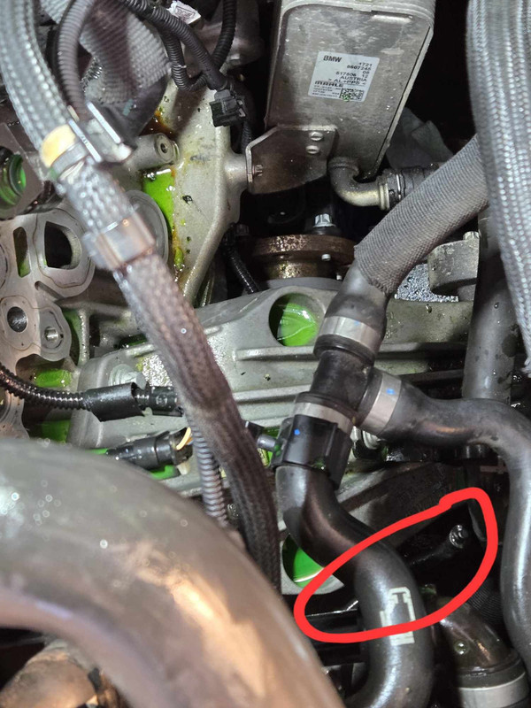

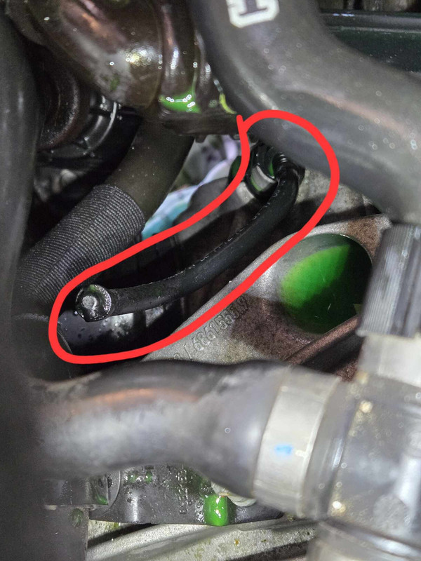

Please help identify this hose. I'm replacing the oil filter housing on my x3 m40i and just noticed this hose which appears to go no where. I don't recall taking it off. Not sure if that's a breather hose or if it broke from somewhere.
