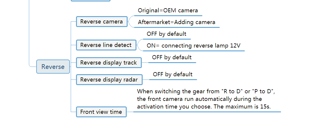

Originally Posted by AbnormallyAspirated View Post
Yes. I just installed a rear camera, and because I have a manual trans, I sometimes "coast" the final part of my reversing, so when I go to neutral from reverse I lose rear camera. and also just normally, the power to the rear camera shuts off slightly BEFORE the screen reverts, and so I get an error message that the signal was lost. So I was hooping there were some parameters for camera power shutoff delay and reversing camera "post-roll".
If I was super-ambitious (I'm not), a diode and a capacitor could solve the 2nd problem.
One can dream!
You may be able to do this: if your front camera is unused, you can connect the front camera signal cable from the MMI to the rear camera signal cable and enable the front camera timer for up to 15 sec or less in the menu. This way after the gear goes from R back to D (and possibly into N) the rear cam will still get a signal for that period of time. This would only work if the MMI senses going out of R vs. going into D. The manual (see below) seems to indicate the going into D from R or from P will enable the front cam signal line for the selected number of seconds. So may not work when coasting in N after R.
But you can also setup where if you switch into R, the rear cam signal stays in a HIGH state with a relay or timer holding it until the MMI detects you switching into D (i.e. the front cam gets engaged). And that would break the timer/HIGH signal going to the rear cam signal cable.

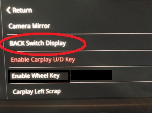

Originally Posted by fe7565 View Post
I am still playing around with mine, but are you able to use the BACK button or only the MENU button on the controller? Under the Settings there should be a way to enable/disable the "BACK Switch Display". Reboot and try again.
May want to try to Enable/Disable Carplay U/D key as well. Reboot and try.
Do your steering wheel keys work?
My steering wheel controls work (volume and scroll wheel). However I do not have a CarPlay U/D option to toggle
Max
Max
When you push the BACK button on the controller are you able to switch back and forth between the MMI and the OEM display view?
Also, your VOICE command button on your steering wheel should activate Siri while in MMI view mode if pressed 3 sec.
The Menu button and the number 8 preset do the same. This is the only way I can get the CarPlay to come back momentarily before it kills the display again. I haven’t tried the voice command, why do you ask?
Max
There seems to be an issue with the MMI reading some of the CAN-bus signals.
May want to map out what works vs does not to narrow down the problem if it's a setting issue vs a corrupt firmware.
Try Carplay via USB and see if it does the same.
Before firmware reinstall, could try to remove BT pairing from OEM HU and also from MMI. And setup from scratch.

Are you using the 12V backup wire from the MMI box? If yes, you can try using the 12V ACC wire used for a front camera, AFAIK there is always current, but I haven't added a front camera yet, so not a 100%...
What is the right wiring for the front camera? I've just fitted one a few days ago but I had to wire it as if It were the rear camera because it was the only way I found where It switched on after the rear camera switches off. I'd like It to power on as soon as I selected D in the gearstick. I Wired positive to camera acc+ (yellow), negative to ground (Black) and trigger wire (placed near to RCA) to the rear camera cable (Blue wire in mmi I think)
I haven't wired for front camera yet, but for rear view I only wired the red wire on the RCA cable to 12v yellow wire (backup/rearview 12v), didn't wire ground or trigger and it works fine for my automatic transmission.
For front camera my plan is to wire the red wire on the RCA cable to 12v ACC, nothing else. They is what I've read should be work.
I mean, as long as it works for you, no need to fix it
I'll try this option but how can it work without ground wire? I Don't Know if the problem is that my rear camera is OEM and it shows image always before the after market front camera
