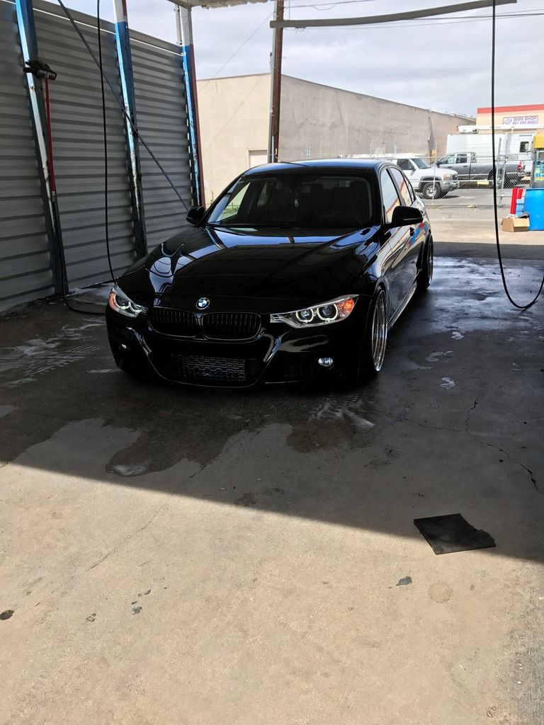

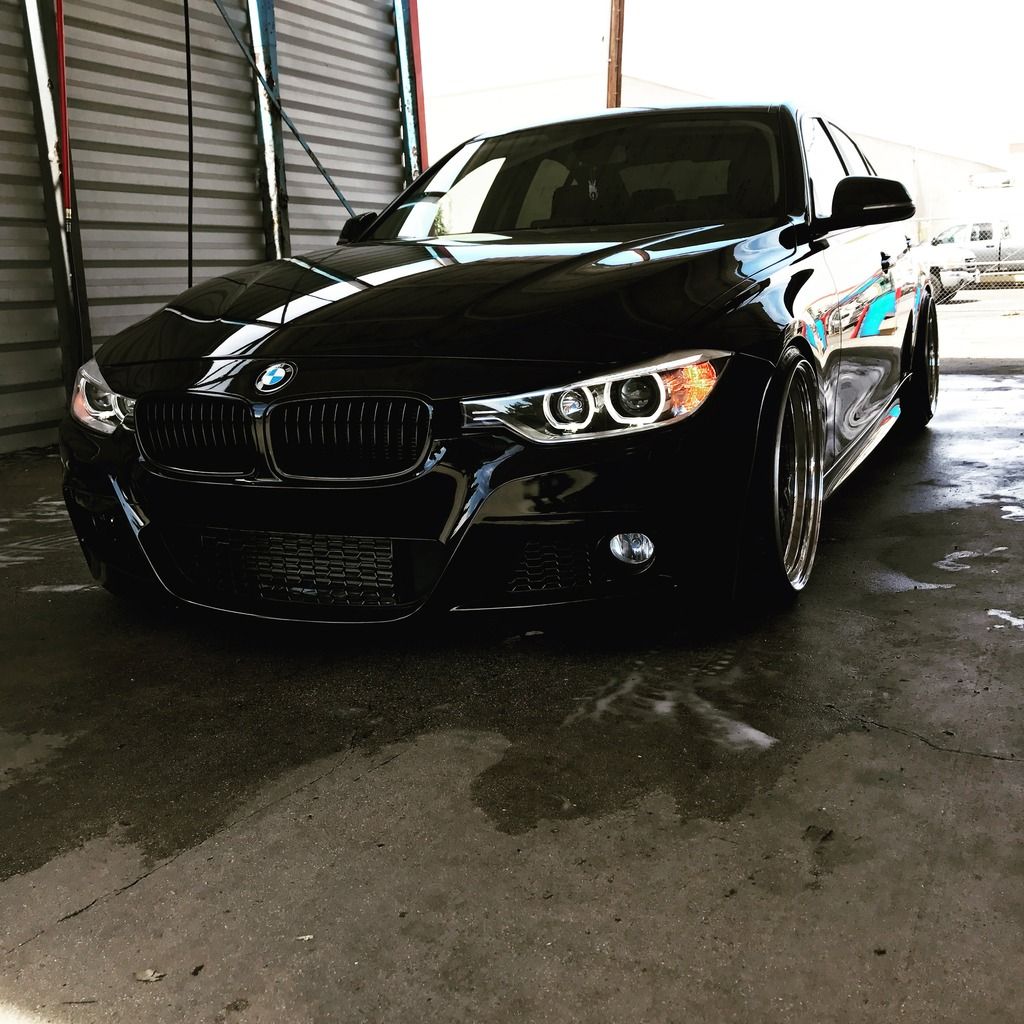

Originally Posted by barad55 View Post
Nice ride bro. Who installed your Depo lights? and have you had any issues? i saw a couple people talking about have some issues in post. is it plug and play? and did you get any error codes?
Thank! So far so good. No issues or any error codes.
Im only running halogen gp thunder headlights and it works just fine.
