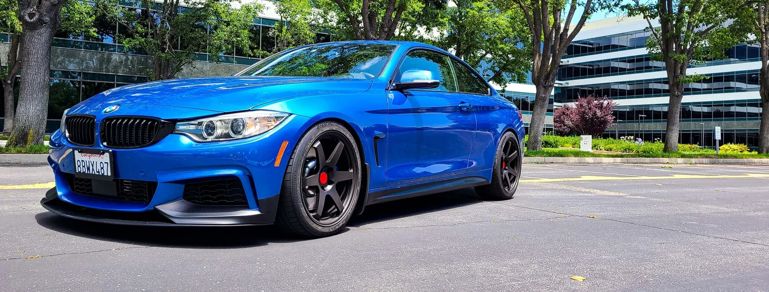

On the rear, I have the 19x10Et40 with a 265/35 tire. Lowered .75" No issues whatsoever.
On the front I run a 235/40-19 on a 19x9ET32 front wheel with a .75" drop.
It rubs under hard compression (when car weight is forward into a bump or deep/low spot in road). I've rolled the fender out and trimmed the fender tab. I noticed the rub is primarily inside the fender (not the edge), which tells me the tire is too tall...
as the 235/40-19 is .4" taller than the 225/45-18 (stock size).
It did this A LOT with Eibach springs/stock EDC shocks. I chalked it up to the spring rates being a little soft and the EDC shocks not quite matched to the springs. With the ST XA coilovers, the compression rub is A LOT less - as the coils are an easy +25lbs to +50lbs firmer than then the Eibachs and the shocks are more sporty in nature, and it's lowered only .75" vs .8"
Personally, I'd maybe go with an offset on the front of like 36 or 38 to bring the wheel in more so the tire move up/down without hitting the inner fender. But ask the wheel people to confirm.
I *think* the 3-series guys get away with wider tires and such because the shape of their fenders is taller/shorter.
Photo is my 235/40-19et32 and 265/40-19et40 set-up with the Eibach/EDC stock shocks drop of .8". Right click and save the image to your desktop if you want to see it "bigger".

Side
Back quarter
