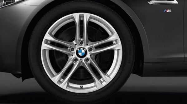

Curious to know if anyone is running Style 613M ... also from recent 5-ers.

Style 613 will fit fine!
Square or staggered setup?
I’m negotiating to buy a set now ... they seem to be hard to find here.
Want to use them on an F31 328i XDrive.
