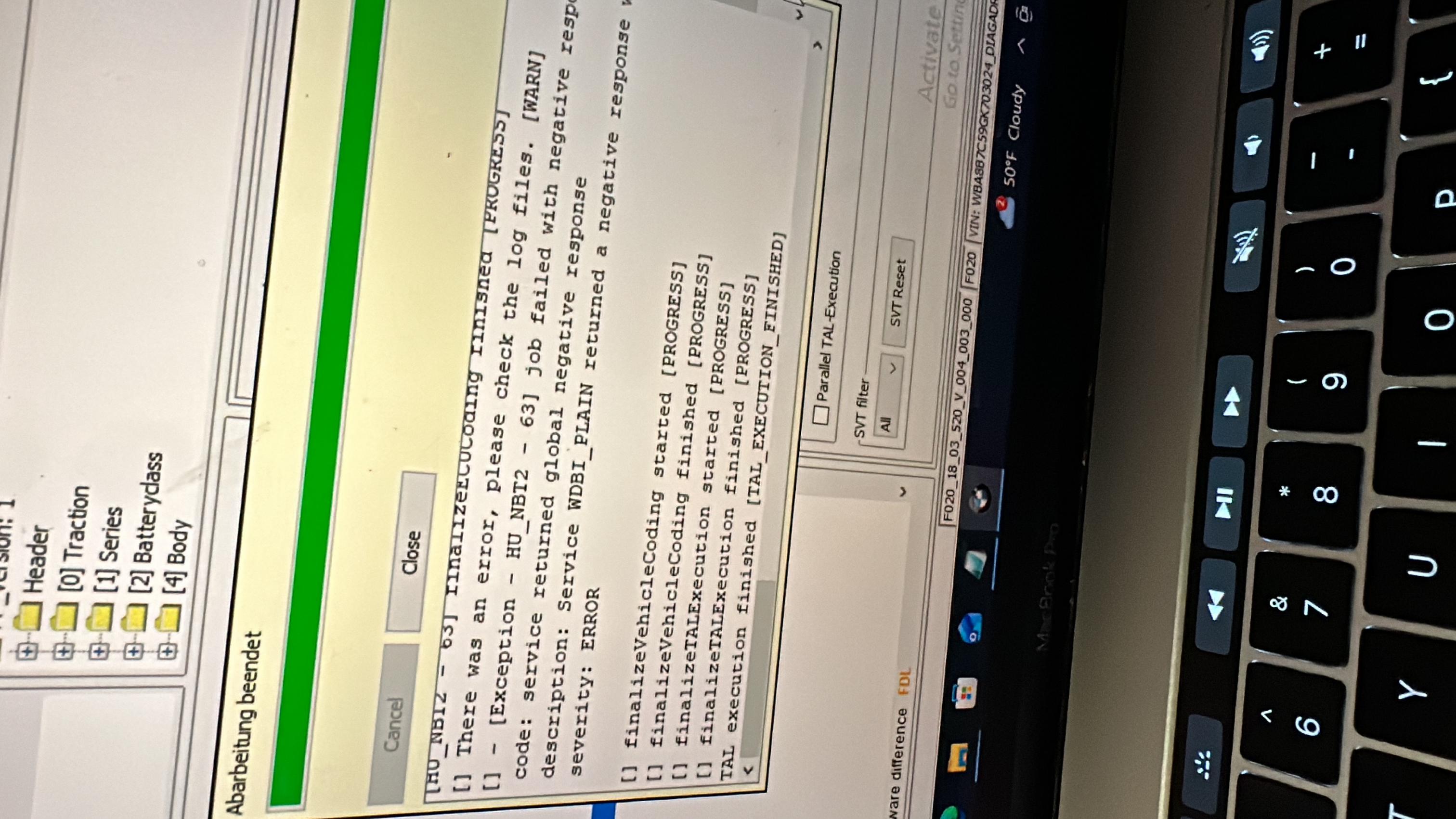

Hi,
I would like to solve the VO code error after NBT HU id6 retrofit, could someone help me?
As far as I understood correct, WDBI_PLAIN error I have means VO locked.
I don't know what SA_SK - SecurityAccessSendKey error means.
Does this imply wrong VO salapa set?
My status:
Vehicle: MY2016 F80 M3,
Car is originally US spec. with NBTevo id4.
Car had been imported to Japan via Germany.
I have been using car without Japanese maps so far but recently NBT HU has crashed accidentally and screen became black.
I bought NBTevo HU with id5 in Japan (so this is Alpine, B216 HW variant: HW4.1) hardware and installed in the car. In E-sys I changed VIN of the HU with using FSC extended function and changed VO options. Then I got the error message and couldn't code when I tried to VO code the HU_NBT2 after cafd injection.
Error message is as follows.
<Caf's suchen>
TAL calculation started.
Locally NCD signature calculation started
Processing ncd signing finished
TAL execution started.
Read SVT before TAL execution started.
<run()-> Value of 'httpServerActivation': true>
<run()-> Value of 'isDeactivateHttp': false>
<ExecutionID=2025/09/13-08:46:06.452>
<[] prepareTALExecution started [PROGRESS]>
<[] prepareTALExecution finished [PROGRESS]>
<[] prepareVehicleForCoding started [PROGRESS]>
<[] prepareVehicleForCoding finished [PROGRESS]>
<[HU_NBT2 - 63] prepareECUforCoding started [PROGRESS]>
<[HU_NBT2 - 63] prepareECUforCoding finished [PROGRESS]>
<[HU_NBT2 - 63] authenticateECUforCoding started [PROGRESS]>
<[HU_NBT2 - 63] authenticateECUforCoding finished [PROGRESS]>
<[HU_NBT2 - 63 - cafd_00001ef6-006_064_014] Transaction type: cdDeploy; Message: TA started [TRANSACTION]>
<MCDDiagService<id=62649, job=com.bmw.psdz.jobs.uds.MCD3_PerformECUCoding, service=WDBI_PLAIN - WriteDataByIdentifier with unlimited Data-ID (plain hex value), description=error: negative response : requestOutOfRange, link=HU_NBT2_63_ETHERNET> [DIAGSERVICE]>
<[] job failed with negative response error:
code: repeat job
description: Service WDBI_PLAIN returned a negative response with response code requestOutOfRange; LinkName: HU_NBT2_63_ETHERNET
severity: ERROR
[THROWABLE]>
<[HU_NBT2 - 63 - cafd_00001ef6-006_064_014] Transaction type: cdDeploy; Message: TA finished [TRANSACTION]>
<[HU_NBT2 - 63] -MessageID is used multiple times, so MessageText may be ambiguous-job failed with negative response error:
code: repeat job
severity: ERROR
[WARN]>
<[HU_NBT2 - 63] - [Exception - HU_NBT2 - 63] job failed with negative response error:
code: repeat job
severity: ERROR
<MCDDiagService<id=230634, job=com.bmw.psdz.jobs.uds.MCD3_PrepareECUforCoding , service=DSC - DiagnosticSessionControl, description=error: negative response : conditionsNotCorrect, link=HU_NBT2_63_ETHERNET> [DIAGSERVICE]>
<MCDDiagService<id=16727, job=com.bmw.psdz.jobs.uds.MCD3_AuthenticateECUforC oding, service=SA_SK - SecurityAccessSendKey, description=error: negative response : serviceNotSupportedInActiveSession, link=HU_NBT2_63_ETHERNET> [DIAGSERVICE]>
code: service returned global negative response
description: Service SA_SK returned a negative response with response code serviceNotSupportedInActiveSession; LinkName: HU_NBT2_63_ETHERNET
severity: ERROR
[THROWABLE]>
<[HU_NBT2 - 63] There was an error during TAL execution, please check the log files. [WARN]>
severity: ERROR
<[HU_NBT2 - 63] finalizeECUCoding started [PROGRESS]>
<[HU_NBT2 - 63] finalizeECUCoding finished [PROGRESS]>
<[] There was an error, please check the log files. [WARN]>
<[] - [Exception - HU_NBT2 - 63] job failed with negative response error:
severity: ERROR
<[] finalizeVehicleCoding started [PROGRESS]>
<[] finalizeVehicleCoding finished [PROGRESS]>
<[] finalizeTALExecution started [PROGRESS]>
<[] finalizeTALExecution finished [PROGRESS]>
<TAL execution finished [TAL_EXECUTION_FINISHED]>
TAL-Execution finished with status: "FinishedWithError".
TAL execution finished. Duration: "18s".
Read SVT after TAL execution started.
Read SVT after TAL execution finished.

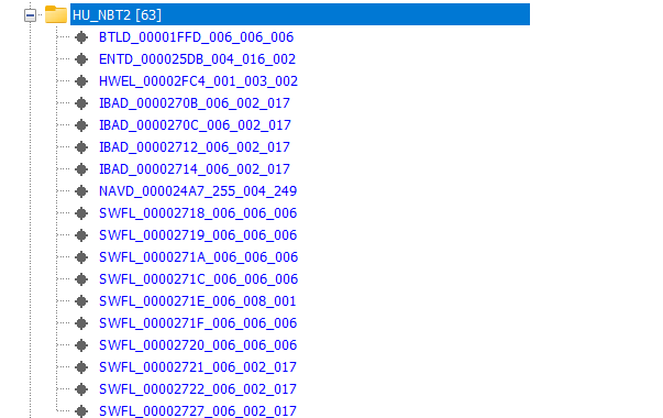

Hi i have the same problem with my hu_nbt2 i have done us to eu region coding. i dont think i have a ecu vo locked i think it just lost VIN but i see it when i check it by ReadDataByIdentifierVIN but on bimmerutility its VIN ??????. but when i codeit back to us the FA and do tal processing cdDeploy than it work back on US
Please help

Do Region Change by FDL Coding, not VO Coding.

So you mean to put it back to us and than fdl code? because now my ECU is without a CAFD.
Or i dont understand the fdl code right ?

Yes, restore OEM COndition, and then FDL Code Region Change.

Originally Posted by billowusu View Post
Im having a weird problem with a headunit i retrofited. Ive done many in other cars but this one is just different. It wont vo code even with vo fix. V850 and reflashed the whole thing, Replaced hdd to sdd. Still same results. Any good way to resolve?
I think if you replaced drive, and Cleared v850, and flash fails, its now a door stop.
Try following
Read ecu and save it. Now write cafd manually in svt and try to vo code it
