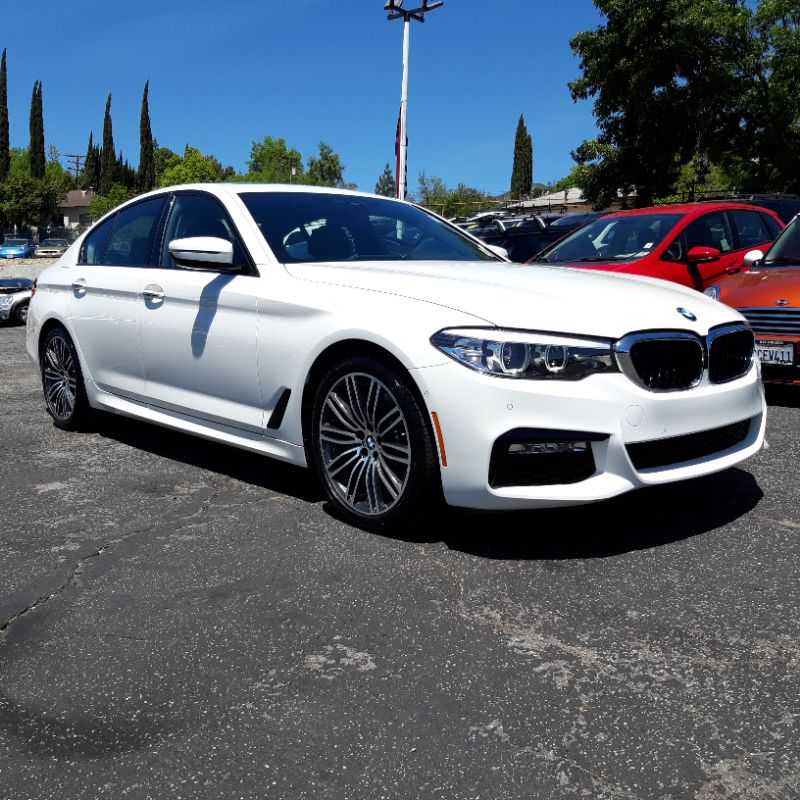

Upgrading stock 17" to 19" on 2017 330i questions
Hi all, I have a 2017 330i with 17". I found a bmw 19" set with Dunlop tires (2018 540i): front 245/40/19r, back 275/35/19r.
will these work for my car?
Do I need to do any modifications or can I just swap them myself?
any other adjustments/concerns needed?
Thank you!

Don't think the offset would work on F30, stay with compatible wheels.

Check the bolt pattern because the new BMWs use 5x112 whereas F30s use 5x120. I could be wrong here, but I believe I've read that in multiple places. Either way, confirm for your own benefit.

Likely that's a bigger setup than what you have stock. Even if the rims could work, to match your current tire's circumference you'd need smaller tires on those rims. Perhaps 35 (front) and 30 (rear) series tires. I don't know what is stock on your car currently to compare..

The simple answer is, G-series rims are not compatible with the F-series, centre hub and bolt PCD are different.

Taller Tire and incorrect wheel rim offset. Beware of the issues all of the above can cause. If you run the 5-series 19" wheels as is on your 3er, I believe the standard tires will rub.
Most stock OEM 19" setups were staggered wheel set up and have higher speed limiter. So the tires are a higher speed tire (Usually "Z" rated or higher) and although they grip better, will wear faster. If you have xDrive, also be aware that these do have specific tire sizes that must be maintained for correct driveline operations. My xDrive runs a staggered 19" in winter and staggered 20" in summer. The front and rear tires must also be inflated at different pressures to keep the tire diameters as close to equal as possible.
Stay with the wheels for a 3-series and avoid any headaches, good luck!
