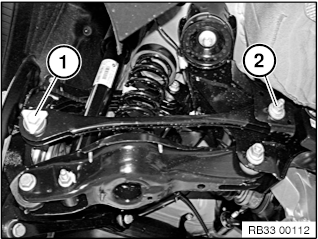

The toe arm is the rear-most arm of the multilink suspension.
The bolt that connects the arm to the subframe (2) is eccentric and controls the toe. It secures with a bolt and nut.

Thanks FaRKle! ! So if there is no movement on the wheel and the bolt that secures to the subframe comes off with an impact wrench, most likely I could just replace that eccentric bolt & nut making it able for the tireshop to adjust the toe during alignment? right?

Yes, if you replace the bolt/nut (probably don't need to replace the eccentric washer on the nut side) the shop should be able to align it. I'd mark the orientation the bolts in now for when you put the new bolt in. Also, the suspension arms tend to be under tension, so just be aware putting the new bolt in might not be as easy as first thought since you'll be releasing the tension on the arm when you take the old bolt out.
