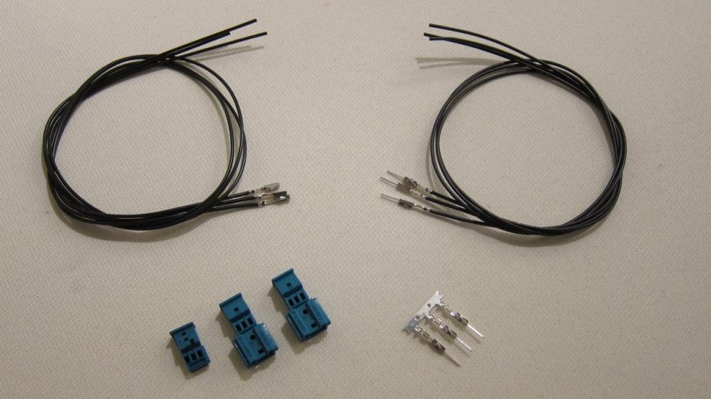

This is the parts list with everything needed to make your own y-adapter:
2x Universal pin terminal uncoded 3 POL. #61136931929
1x Universal socket housing uncoded 3 POL. #61138377072
3x pin contact 0,2- 0,5MM² #61130005198 (comes with crimped on cable!)
3x bushing contact 0,2- 0,5MM² #61130005197 (comes with crimped on cable!)
3x pin contact 0,75 MM² #61131393723 (without cable)
This is what you get:
Assambling the Adapter:
- Click the 3 male pin contacts with cable (#61130005198) into one of the pin housings (#61136931929)
- Click the 3 female bushing contacts with cable (#61130005197) into the socket housing (#61138377072).
- Shorten all 6 wires to a lenght of about 10cm. Strip the insulation about 4-5mm on each wire.

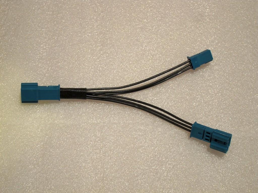

*Caution: The next step is extremely important!*
Make absolutely sure to connect the wires in correct pairs!
The pin assignment is brown Pin1 (ground), red/white or red Pin2 (orange LED), blue/white or black Pin3 (white LED).
Since all wires of the adapter are black, you need to find the pairs with the corresponsing pin numbers (1,2,3) imprinted on the green pin and socket housings.
For the next steps I strongly recommend using a crimp tool for dupont contacts!
- Connect the two wires for Pin1 by twisting the wires together.
- You'll have to crimp one of the single pin contacts (#61131393723) onto the connected wires. If using pliers to crimp, click here for details: link
It takes some practise to get it right, so the crimped contact with the two wires fits into the remaining pin housing. I found it useful to widen the openings of the contact housing with a sharp blade.
- Make sure to push the contacts all the way in until you hear a slight 'click'. Only this way the pins are secured in the housing and won't come out again. Push down pin lock on the connector.
- Make pairs for Pin2 ans Pin3 the same way.
The result should look like this:

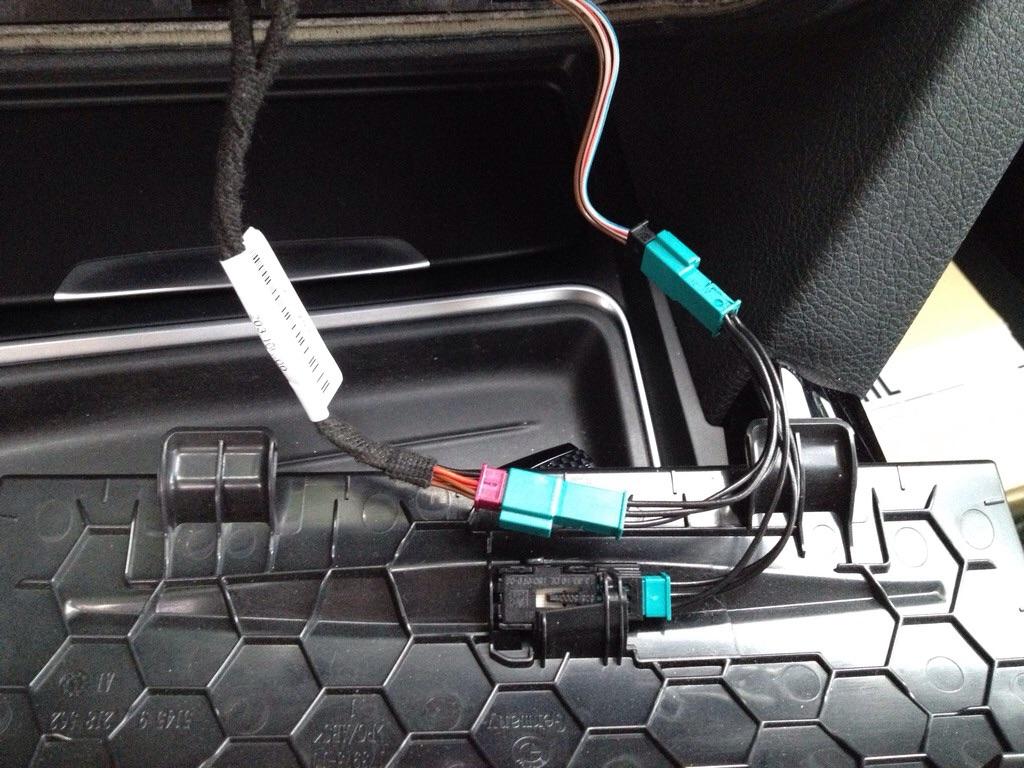

This is what the adapter looks like mounted in the car:
There you go!
