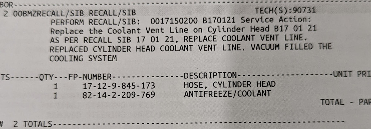

I just had this replaced on my 2018 330i at my dealership.
| 2018 BMW 330i | 35k Miles | M-Sport Package | Driving Assistance Plus | Premium Package | Executive Package | Harmon Kardon | Active Blind Spot Detection | PDC | Mineral Grey Metallic/Coral Red Dakota Leather |

Originally Posted by Aziego View Post
So they call the vent tube replacement as a technical enhancement. This is what I get from the bmwgroup site.
"There is an open technical enhancement on this vehicle. Please go here to book an online appointment for your vehicle selecting "service as required" or contact your local retailer here for more information. Enhancement code 0017150200."
That code matches my image above.
