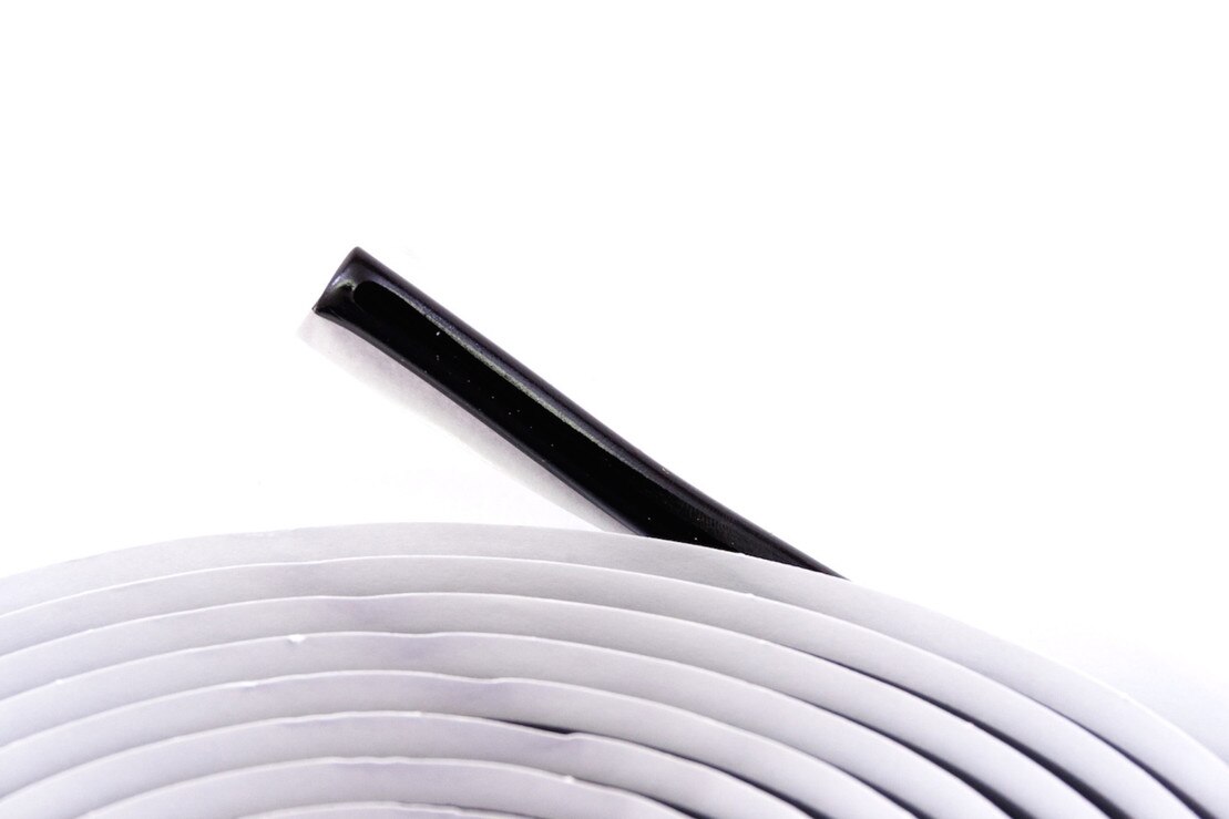

I used butyl leftover from a headlight retrofit for mine, could have probably done a neater job but it did the trick and cant see it unless looking for it:
Ignore all the deadbugs lol:
The stuff comes as a roll, super mailable when warm, stretchs and easily fitted/shoved in the cracks. stays in place:
Under $15 on amazon: https://www.amazon.com/s?k=headlight+butyl
