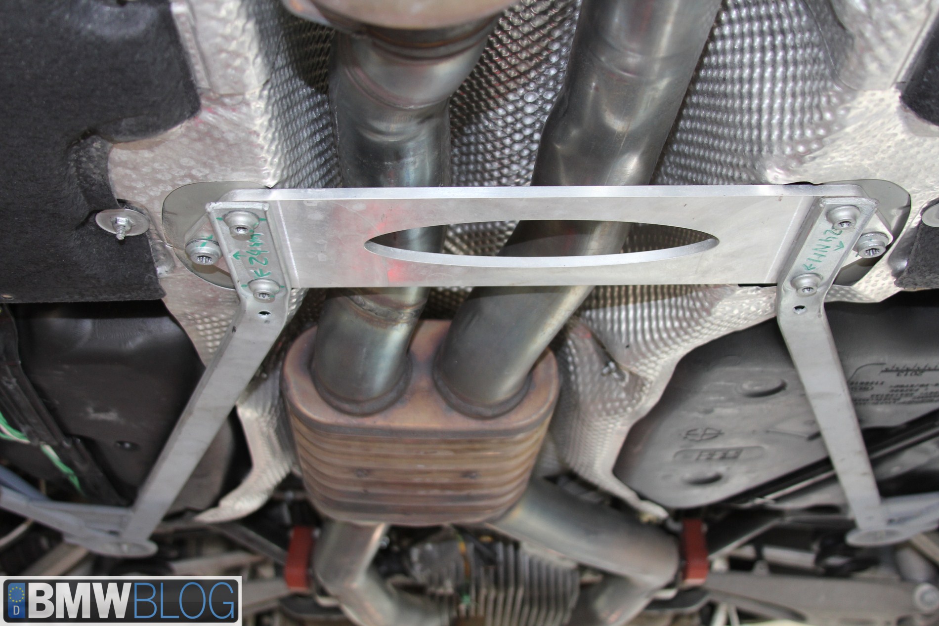

How about using oem F8x underbody brace
http://www.bmwblog.com/wp-content/up...arriage-06.jpg
Thank you! Looks similar to the CPM one. I wonder what the OEM one costs?
There you go!!!
OEM+

It'll have a placebo effect and will certainly lighten your wallet. Of these 2 things I am certain.
Comparing the 2 pics, the OEM F8X piece looks to be made from aluminum vs steel for the OEM F3X.
Item # 2 in the attached realoem page. Part no. 33312284647
http://www.realoem.com/bmw/showparts...81&hg=51&fg=80
Thank you! I just looked it up...$15!!! LOL! According to the sites I searched this part is already on my car. The CPM would replace this. I wonder how much more rigid the CPM one is?
The part number I quoted is unique to m3/4 fxx. Your car is likely to have same as mine ie a connector plate made of pressed steel. The alloy one will be lighter and more rigid.

I plan to remove existing pressed steel bracket, install oem M3/4 alloy bracket as a spacer, with longer bolts under the existing pressed steel bracket, increasing stiffener effect.
