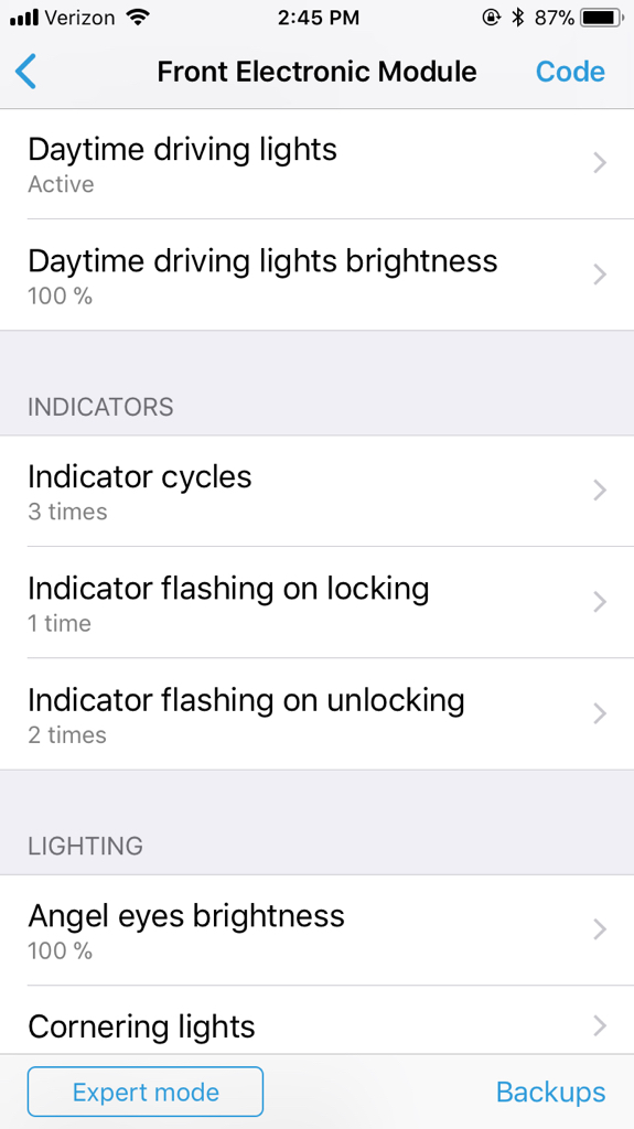

You can change the brightness but for that specific option for all light switches, I used Carly.
My DRLS (Angel eyes) stay on at 100% on any switch except for low beams. They then drop to about 20-30%.
Still working on that one.
