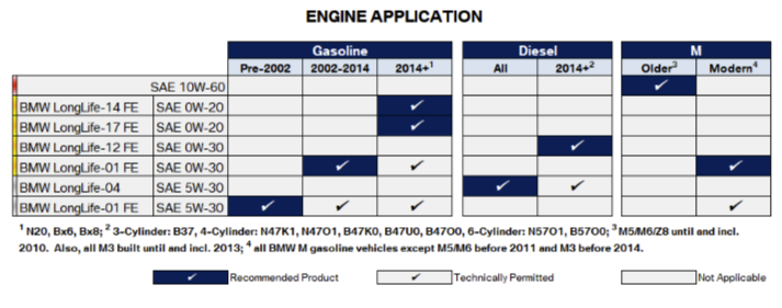

I have a 2016 F36 w/ the N26 engine; under the hood it specifies that I use 0W-20 oil and I want to stick to the recommended oil by BMW (I live in California btw).
Are there any other oils that meet BMW standards (i.e LL-01, LL-14+) and are aligned w/ the 0W-20 specs that are not the rebranded BMW oil the dealer sells?
I spent about 2 hours now trying to find the best oil to use in my car since my oil change will be a DIY and is due in about 600 miles.

LL01(LL04) requires an HTHS of 3.5 or more. That will be 0/5w-30/40 oils.
LL01FE(LL12FE) has a HTHS of 3.0 and will be a 30w.
Everything else is going to be 0w20.

LL01 is a dying specification with BMW moving to 20w oils. Mercedes and Audi/VW are moving away from these heavier oils as well.

I did a search up on the actual pennzoil website; input my vehicle info (2016 F36 GC, N26 engine cus it's SULEV) and I was quoted for Pennzoil Euro Ultra Platinum 0W-40, even tho my engine label states 0W-20.
Would any harm come from following the websites recommendation? Sorry, I'm new to all these oil labels and terms lol
It's LL01 and fine for your vehicle. See link for oil certs for your engine.
https://www.newtis.info/tisv2/a/en/f...l-note/1PSryV8
https://www.newtis.info/tisv2/a/en/f...l-note/1NBygtn

As per BMW. Oil selection is pretty straightforward and I never understood the need to avoid what BMW tells you is recommended and what is allowed. If you choose not to follow BMW's guidelines, then pick any oil you want because it's the cheapest or because it's used in a Porsche or a Ferrari.

BMW branded 0w-20 falls under the European specification of ACEA A1/B1. Pennzoil 0w-20 Ultra Platinum meets that spec, so you are good there if that’s what you choose to use. It wouldn’t surprise me if Pennzoil Ultra Platinum (or the European equivalent from Shell, which owns Pennzoil ) is what the original fill was. That said, are you sure that’s what you should be using? I downloaded the owners manual for your car, and recommendations are for viscosities from 0w-30 up to 5w-40.
