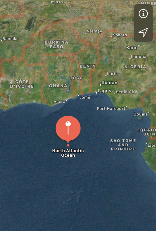

Hello mates I just bought a 2014 BMW F30 320d. I have the 2014 EUROPE Next map on it and the NBT multimedia. Now I am facing with a problem, the navigation starts without any issues but however it shows that my car is in the ocean O.o
I really thought this was just a bug but it seems it's stuck there and does not move anyway ( while my car is moving the navigation gps stays in the same location in the ocean ). So I tried to put a destination and i found my city in the navigation set a destination but it says: Unable to calculate route.
Does someone know what could be facing my problem. Is it the maps that need updating, or is it a gps related problem. I've read about some issues with antenas, could be it? Can I replace the antena on my own? If anybody had this problem please share some info on how you got it solved. Thanks

Is that coordinates 0,0?
Your gps antenna might have disconnected
0,0

0,0
Hello thanks for the reply. Yes those are the coordinates. How can I check my antena? Please I am trying to fix this with no luck, I tried everything software related. Where is the antena locate, is it on the shark fin on the top of car or somewhere in the trunk?
