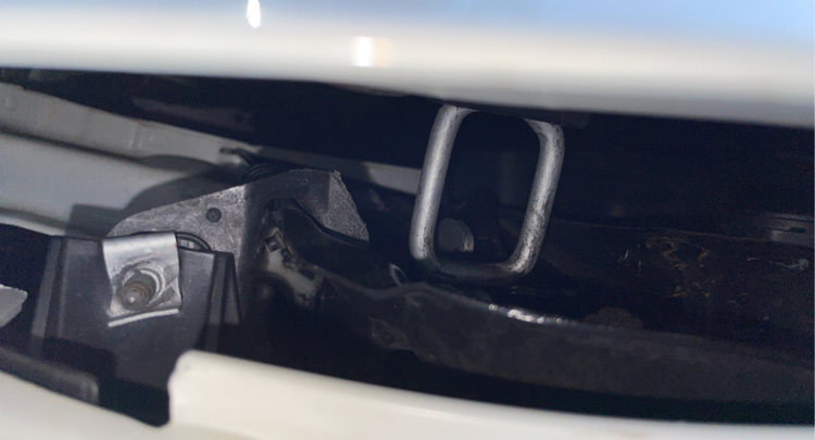

Have had this gap between hood and bumper for months. Already tried adjusting the bumper and the knobs on the hood nothing has worked. Any one else have this problem[IMG][/IMG]

Try checking the 2 catches in engine bay. They can be moved if you don’t close the hood lid hard enough. I managed to move one of mine whilst cleaning it. Hood wouldn’t close. The catches clip around the U-clip brackets in your photo. Try manually moving the bracket on the side that’s showing high. After checking your photos again it looks like the 2 ‘hooks’ on the catches are pushed forward & the hood is hitting them. Try pushing the hooks backwards. If it works ok, ensure you ‘drop’ the hood from about 30cms to ensure it closes properly. Hope it works for you. Cheers.

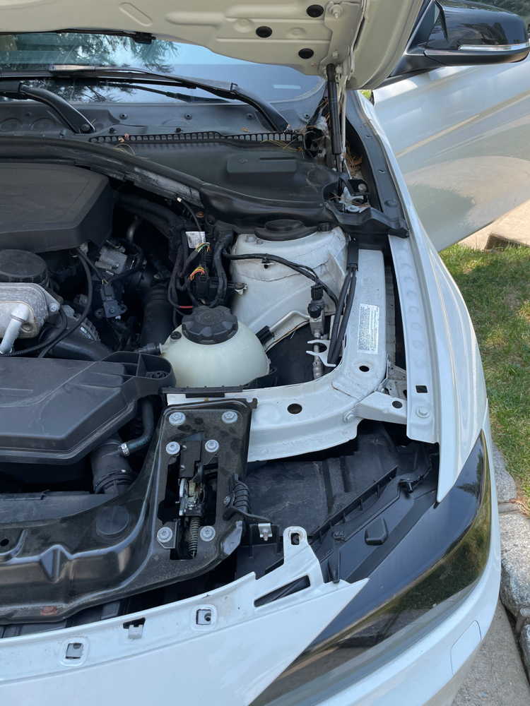

Looks like you are missing all the screws for the top of the bumper. Did you recently just install those black grills?

Your front bumper isn't even screwed on, and you've started 3 threads asking why it doesn't align while ignoring all of the comments? You could at least try to be subtle if you're going to troll these forums. Otherwise, leave your "modding" attempts to a professional.

In case it's not obvious what others have pointed out, it looks like your bumper is not attached at the top, there are supposed to be bolts in these positions on both sides:
What exactly did you do when you say that you adjusted the front bumper?
