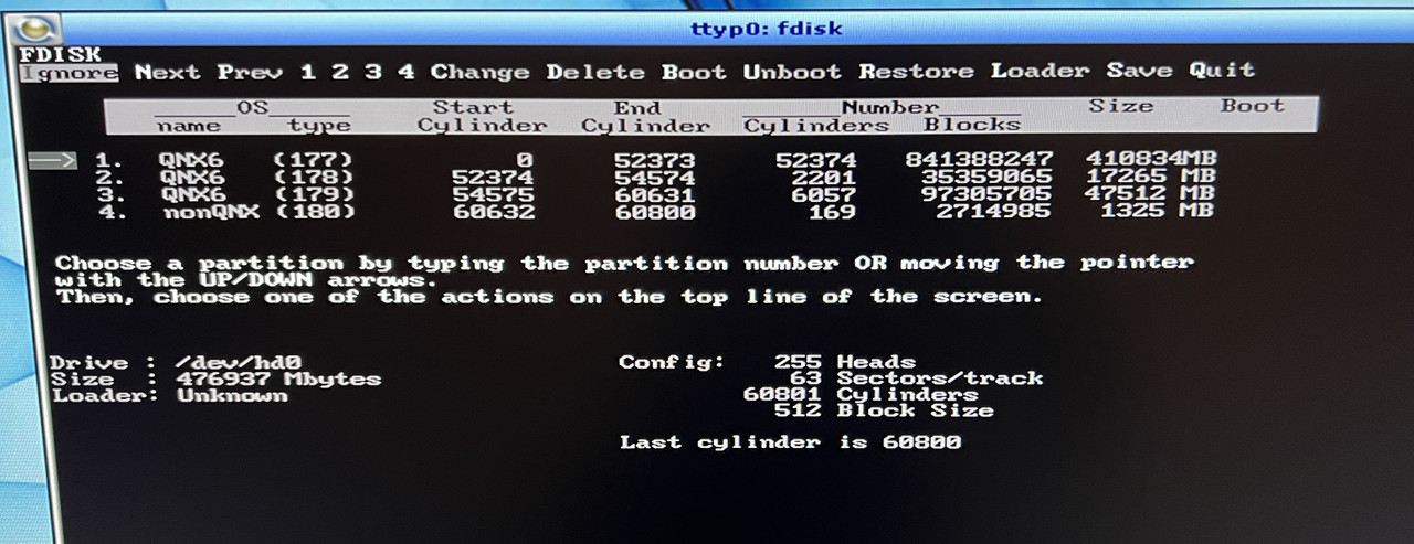

    - Ensure you've modified the script correctly based on your replacement hard drive size. For the MQ01ABD050 use the following:
    Code:
    BLOCK_SIZE=512
    ## new partition table
    HDD_SIZE_200GB=60800
    DEF_DATA_200GB="177 /mnt/data rw 52374"
    DEF_SHARE_200GB="178 /mnt/share rw 2201"
    DEF_MEDIA_200GB="179 /mnt/quota/mm rw 6057"
    DEF_DEBUG_200GB="180 /mnt/quota/sys rw 169"
    In the script, also modify the DEVICE parameter to something other than

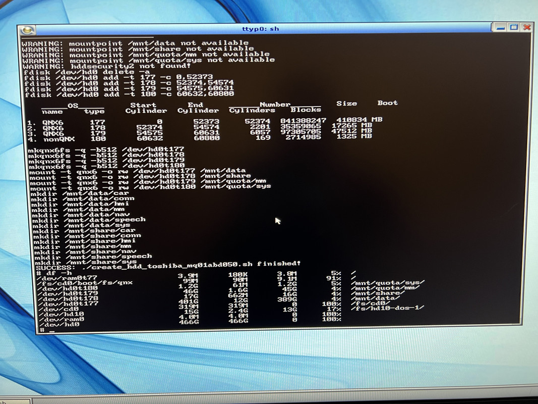

    After editing you can execute the script:
    ./create_hdd.sh -i
    This will execute fairly quickly and should report a successful message.
    You can now shut down the VM and disconnect your replacement harddrive and reinstall the reverse steps.

It's a bit clunky. I copy the files from a FAT32 formatted USB stick (which for me is auto mounted in QNX as /dev/usb0) to the /home folder which is just a RAM drive. If it's the same for you then what I do is this:
cd /fs/usb0
cp create_hdd.sh /home
And you can check it's there by doing:
cd /home
ls
The script probably needs the executable permission set so do that then execute the script by doing:
chmod +x create_hdd.sh
./create_hdd.sh -i
You can verify the partitions by running fdisk /dev/hd0 (if that's the device that it appears as. However if you've put the drive in NBT and booted it up then it might have locked it and it needs unlocking to be readable in anything else. If you put up a screenshot of your fdisk output we'll be able to see what's going on.

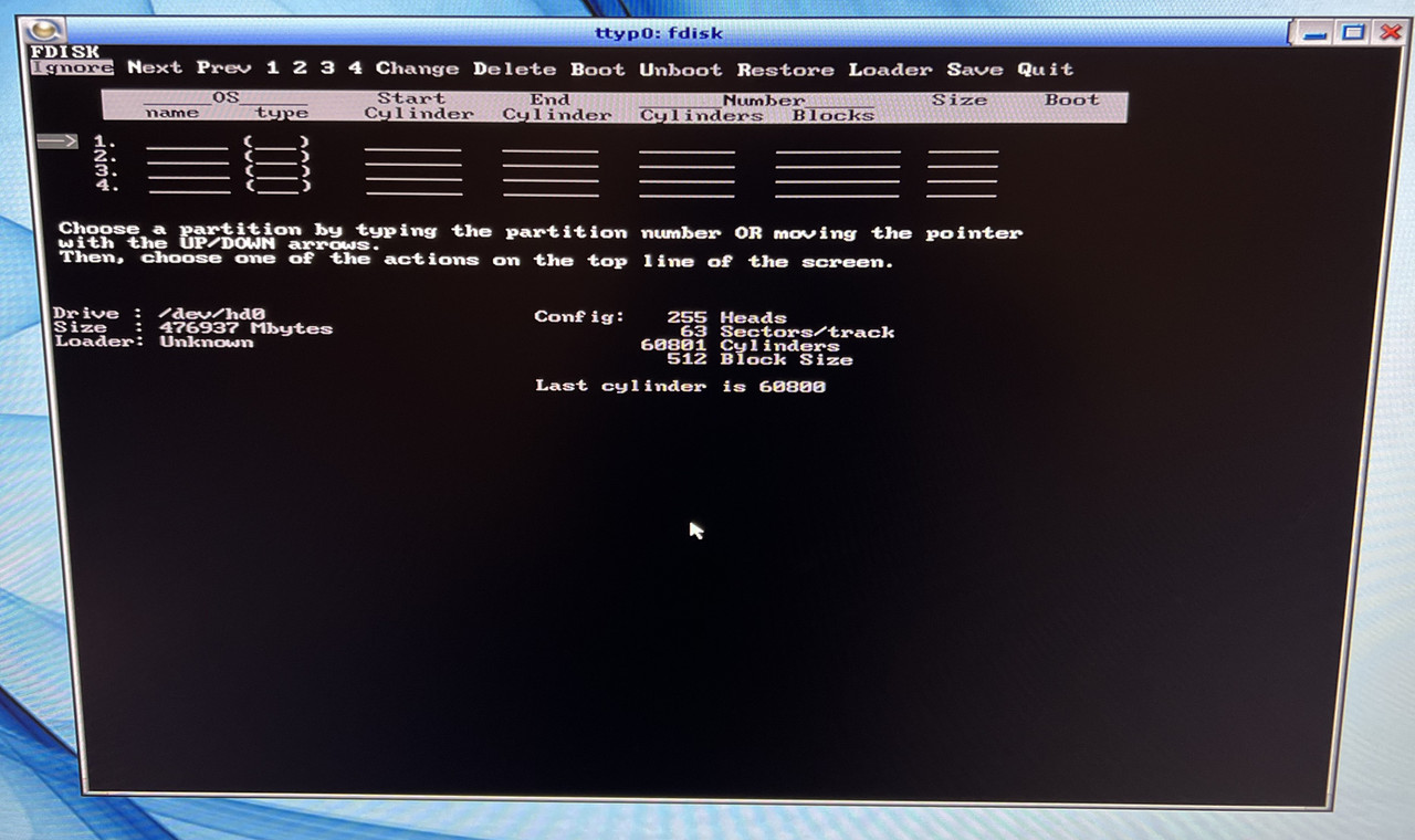

I looks like the harddisk isn't locked. I looked at fdisk again and it had really strange partitions with DOS in front of it instead of QNX6.
So started all again and made the 4 partitions as per instructions on the bimmerfest forum. after that saved and quit. Then did the format commands. All went well.
But then I made a fault. Instead of using "mount –t qnx6 –o rw /dev/hd0t178 /mnt/share" I used RO instead of RW. Also did this for the other partitions. Only 177 should have been done with RO.
But now when I do enter the right command with rw I get the following message. see attachment.
I then deleted all the partitions in Fdisk, made them again did the format commands again. But keep ketting the same fault.

It seems your partitions are the wrong way round. 177 should be the first starting at cylinder 0 or 1 and you have 180 so that's probably why it isn't happy. My 4th image in this post shows the resulting partition table after running the script and you'll also be able to get all the commands the script runs in the 3rd image.
So here's the outputs I get. I've modded the script with the correct cylinders for a 500GB drive so that's the file I'm using. Also it's interesting to note that this USB stick I'm using appears as hd10-dos-1. I think opening the ISO and copying the script into your ISO so you have access to it from the virtual disk within QNX is the way to go.
Sorry about the crappy pics, I'm booting QNX natively rather than using a VM.
Firstly I booted into QNX then I ran fdisk /dev/hd0 and deleted all existing partitions on the drive then rebooted QNX to clear any automatically mount points. Running fdisk /dev/hd0 after a reboot confirms it's clear:
Running df proves that the drive is there with no mounted partitions:
I run the script with -i parameter which automatically creates the correct sized partitions, mounts the partitions to the paths displayed and creates the empty folders it displays. Running df again verifies the 4 partitions and mount points:
Lastly, here's the output from fdisk /dev/hd0 showing the partitions:
Hope that helps in some way.
