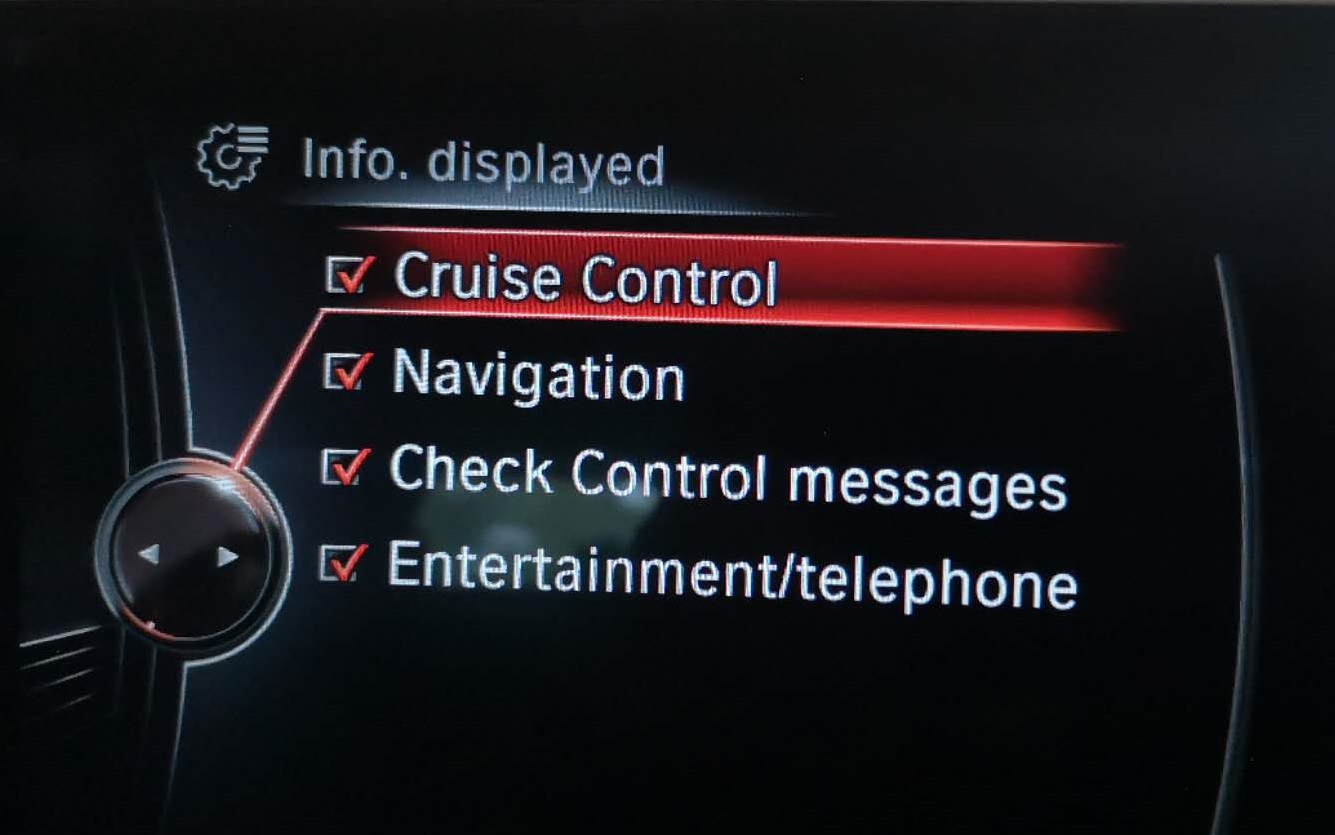

Just checked my car. Hope this helps: settings > head-up display > information displayed > the. make sure speed limit is checked.

I only got these on my menu.
Made a few request to bmw shops, they said their SLI modules only intake info from navigation maps instead of KAFAS. looks like theirs are emulators.
is "VO code to enable the feature" means using bimmercode to enable it?

You may be able to code it via Bimmercode, but I'm not sure where to start. I'm assuming multiple modules would need to be coded to support it like the cluster, head unit and FEM so you would probably need someone that knows how to do more advanced coding with Esys to enable the feature.
Have you tried checking mdecoder dot com or a similar VIN decoder site and plug in your VIN to see if you have "speed limit information" already?
