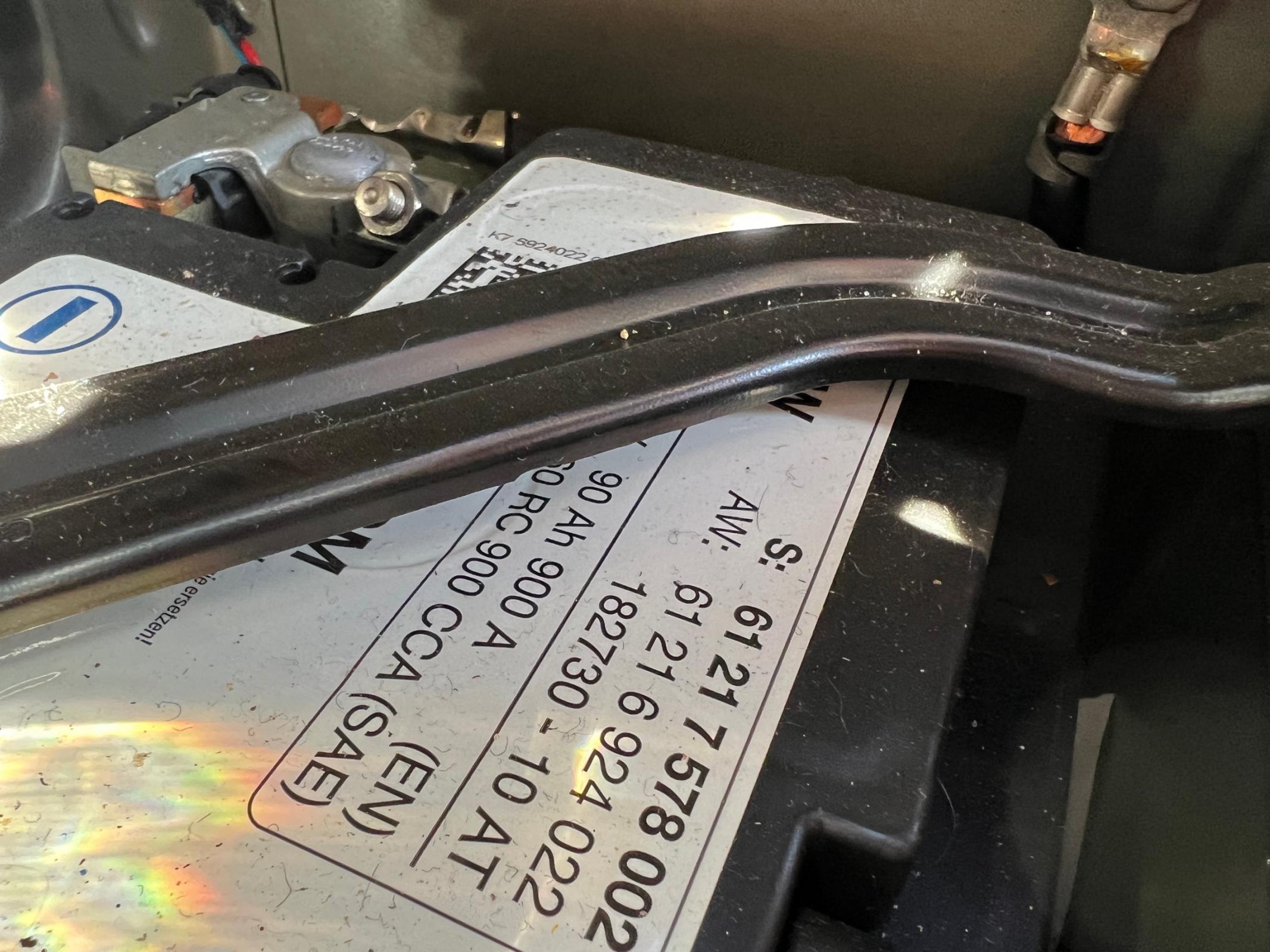

Ok so turns out my 2014 335i has the original battery from 2013 and it’s slowly giving out.
My OEM battery is 900cca 90ah.
I’ve done research and looking at a Johnson Controls battery from either Autozone or Walmart.
The price difference is about $100.
Walmart ONLY has a 850cca battery AGM h8 all that, for about $170. Although they advertise the 900cca online it’s not available.
Autozone has the precise match..
My question is, does the 50cca make a difference at all)

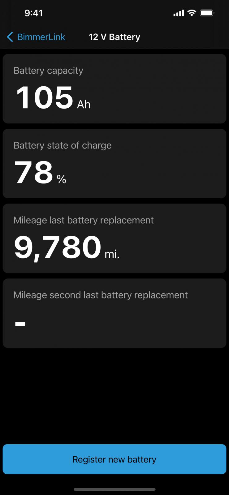

Bimmercode will do it. The options are 55, 70, 80, 90 and 105. An exact match isn't necessary. Code for the nearest AH not higher than the battery rating.
      02-10-2023, 04:45 PM   #17
Qsilver7
Qsilver7's Avatar
6500
9,821
Drives: F06 650ix GC / F15 X5 50i
Join Date: Oct 2016
Location: Indiana, USA
Ditto...Bimmercode provides "coding" capability...but you will need their sister app (BimmerLink) to register the battery.
Coding and registering are TWO separate functions.
