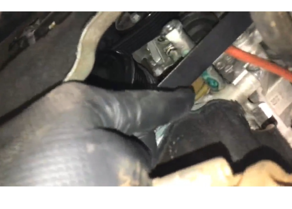

Water pump leaking at 28000km!!!!
Finally detected by BMW techs.
So much for buying expensive quality vehicle 😒

BMW service performed a pressure test and NO leaks were detected.
On closer visual inspection it was found that the water pump was weeping coolant, evident by the coolant crystals observed. Just remove the lower cover under the motor and take a look.

I took the panels off my car today and i do think it is the water pump. It was difficult for me to see as i have xdrive and the front differential blocked the view. But I did see white residue at the top of the water pump housing. So that can only mean that coolant was weeping out.
